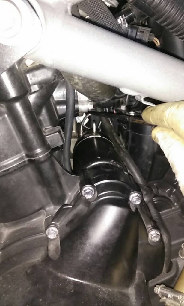

Just thought I'd give a quick update ...
Parts for the starter arrived but the following day, before I had time to service the starter I had in hand, the upgraded -4452 starter arrived in the post!
Needless to say I just jumped on it and fitted it! I was quick to put it in place but I just couldn't gather enough strength in my fingers to push into its recess.

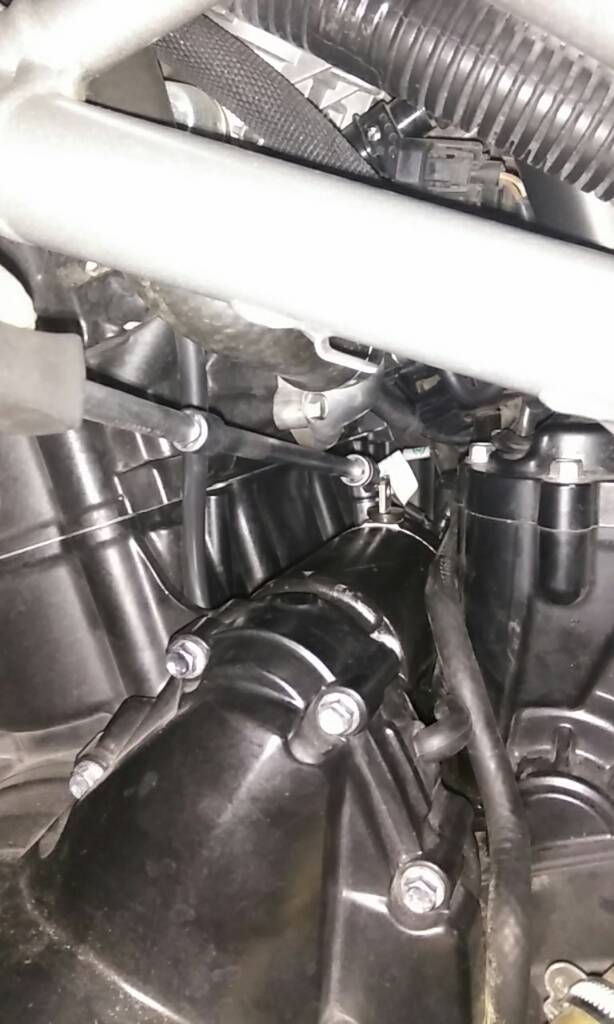

I took a few photos ...

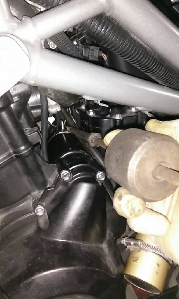

Once in position, I used a sliding hammer to be able to push it into its seating:

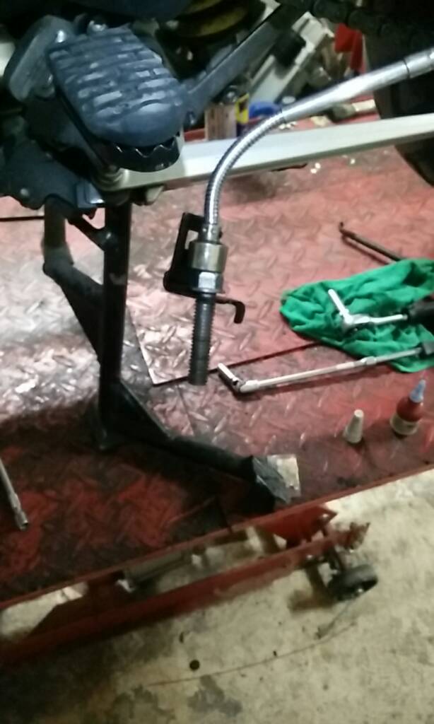

I used a retrieving magnet to be able to position the starter mounting bolts being the starter where I couldn't see them ...

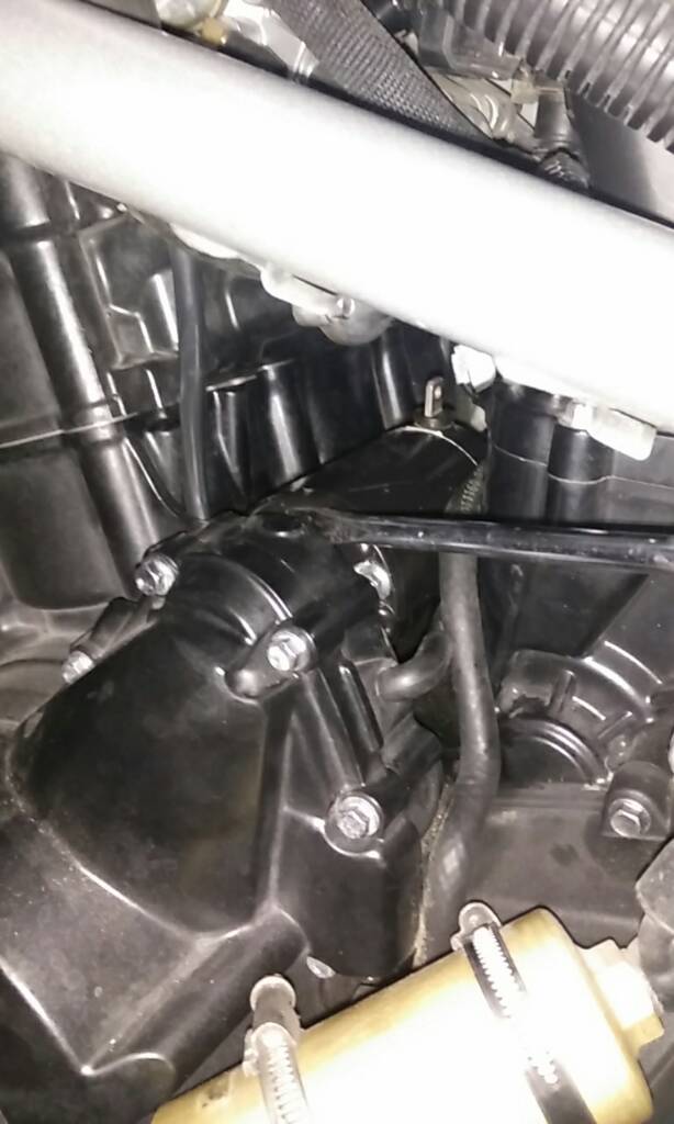

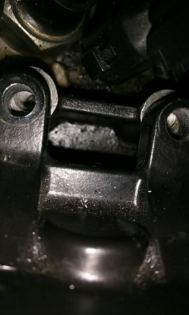

But the bolt just wouldn't start screwing into the thread ... So I got my phone in position since I ain't got a borescope and took a photo of what I couldn't see:
Aha! Holes not aligning, no bloody wonder!!! So I got a flat screwdriver and prayed it back out a few mm ...
Now the trick was to be able to reach the head of the bolt, turn it and tighten it! Good luck Dave!

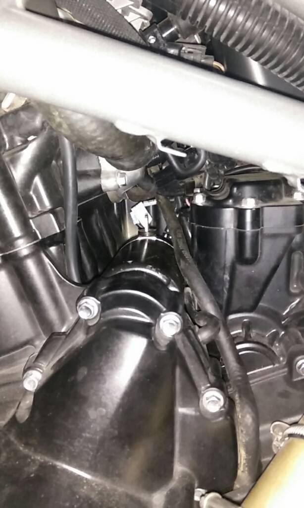

So out comes the UJ and an unlimited number of different sized extensions and 8mm sockets!
Just make sure you're aligned properly and the UJ is well greased otherwise you wouldn't manage to turn the bolt!
There, easy does it.
Now the rear bolt, the one with the little bracket on it ... this is going to be a nightma ... oh hang on, where's the magnet again?
The magnet held the bracket in place and since there's a little tab on the bracket, the bracket wouldn't turn when I tightened the rear bolt!

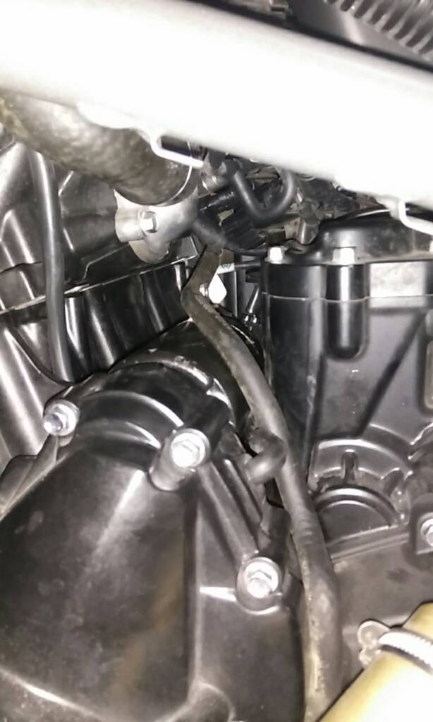

You definitely need to shift this hose from here:
To here ...
... using the starter's lead attachment as a hook to hold the hose otherwise you wouldn't manage to get to the rear bolt to tighten it!
Then just clip the block connector to the little clip behind the starter, attach the power lead to the starter tab, mount the rear shock reservoir back in place by tightening the two jubilee clips on it to the frame tabs again and Bob's your uncle! Done!
I will now service the old starter at the first chance I get so I'll keep it as a fresh spare in the garage just in case another ordeal like this pops up!!!
