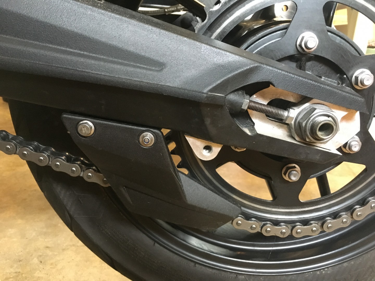

Just bought a Cobra Nemo 2 chain oiler and i'm struggling to see how to mount the dispensing arm down near the rear sprocket and chain (2017 Tiger XR). Has anyone got some pics or info please.

I secured mine under the swinging arm, so the feed pipe comes down just in front of the rear sprocket (2017 XRX)

Photos of my attachment.  The 1st two are straight after fitting, the 3rd is after is got dirty.
I used the two bolts holding the lower chain guard and a twisted marine grade SS wire to complete the triangle and keep if firm.  The U channel is glued to another strip of metal to match the chain guard bolt spacing.  It works well and is out of the way.  If the chain rubbing strip needs replacing then I will have to detach it probably and refit.
Don't let the pipe get too close to the cog otherwise it will get eaten!
