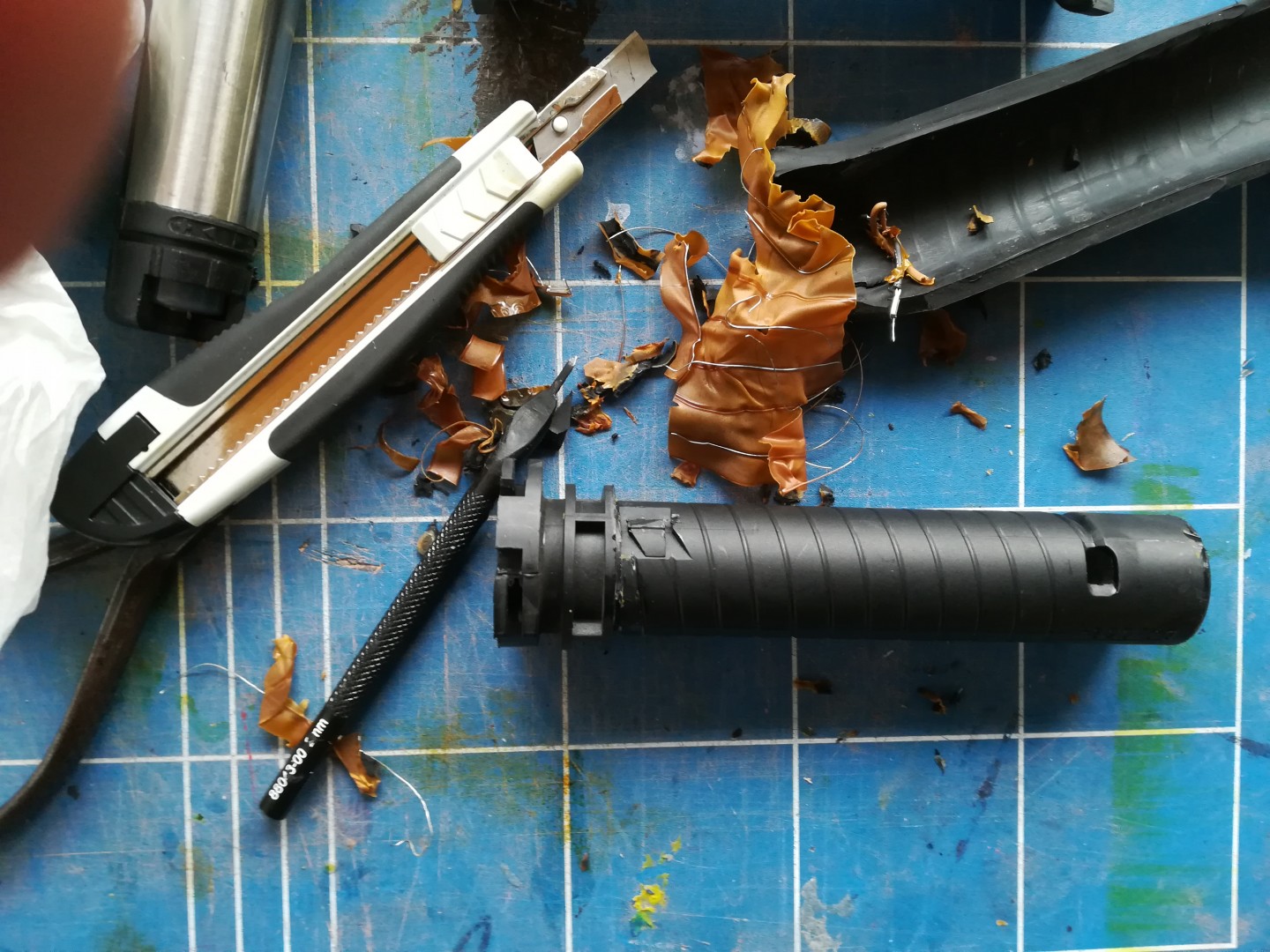

Started the replacement today.  All going well.........until trying to get grip over throttle tube.
No won't go.  Outside diameter of the Triumph heated grip tube is 26.55mm  Internal diameter of Oxford grip is 25.55mm
The tube was easier to clean off than I thought.  Required a small craft knife and my trusty gas powered iron with the hot air attachment.  The Triumph heated grip is only glued at either end around the circumference.  Once the grip was off I was able to heat the covering of the heating element and literally peal that off.
Have ordered a replacement grip/tube from Fowlers but will try the Lathe on Monday to reduce the tube diameter.
