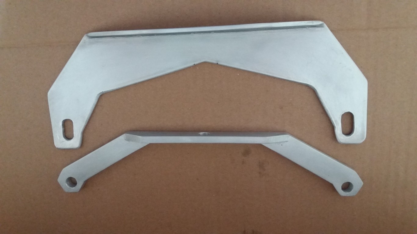

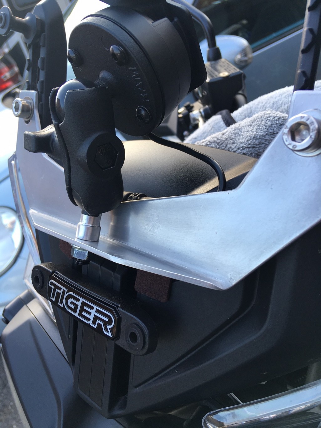

Big Thanks to Mike, new bracket arrived and I cleaned it up, drilled the holes and painted it with silk black. While waiting for the cast bracket I had a go at making my own bracket. worked out ok and is sits lower than Mikes bracket which allows the Tom Tom to sit just above the instruments.
However, Mikes bracket is smaller and higher which allows the Sat Nav to be mounted closer to me, the rider, so I should be able to see it better!
I have not had chance to have a ride out yet but I am sure it will work well.

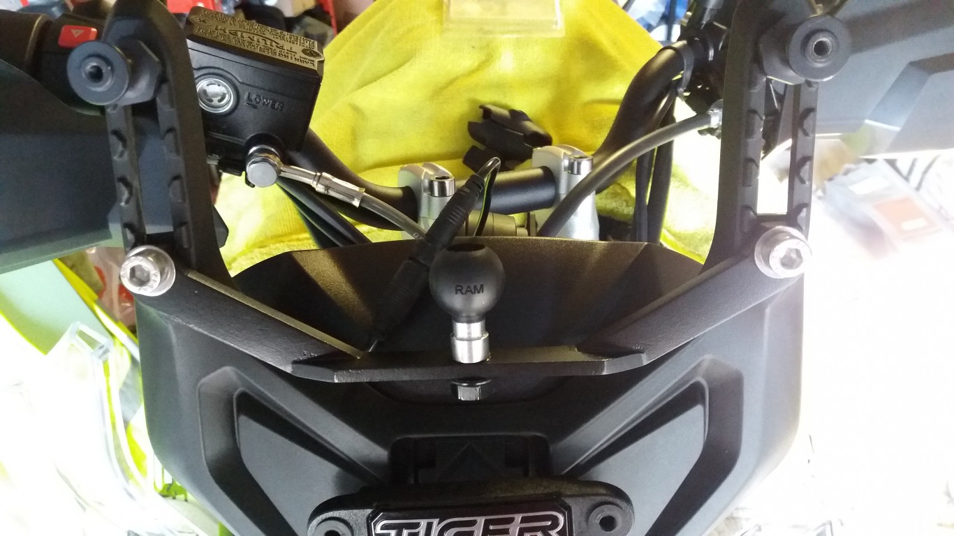

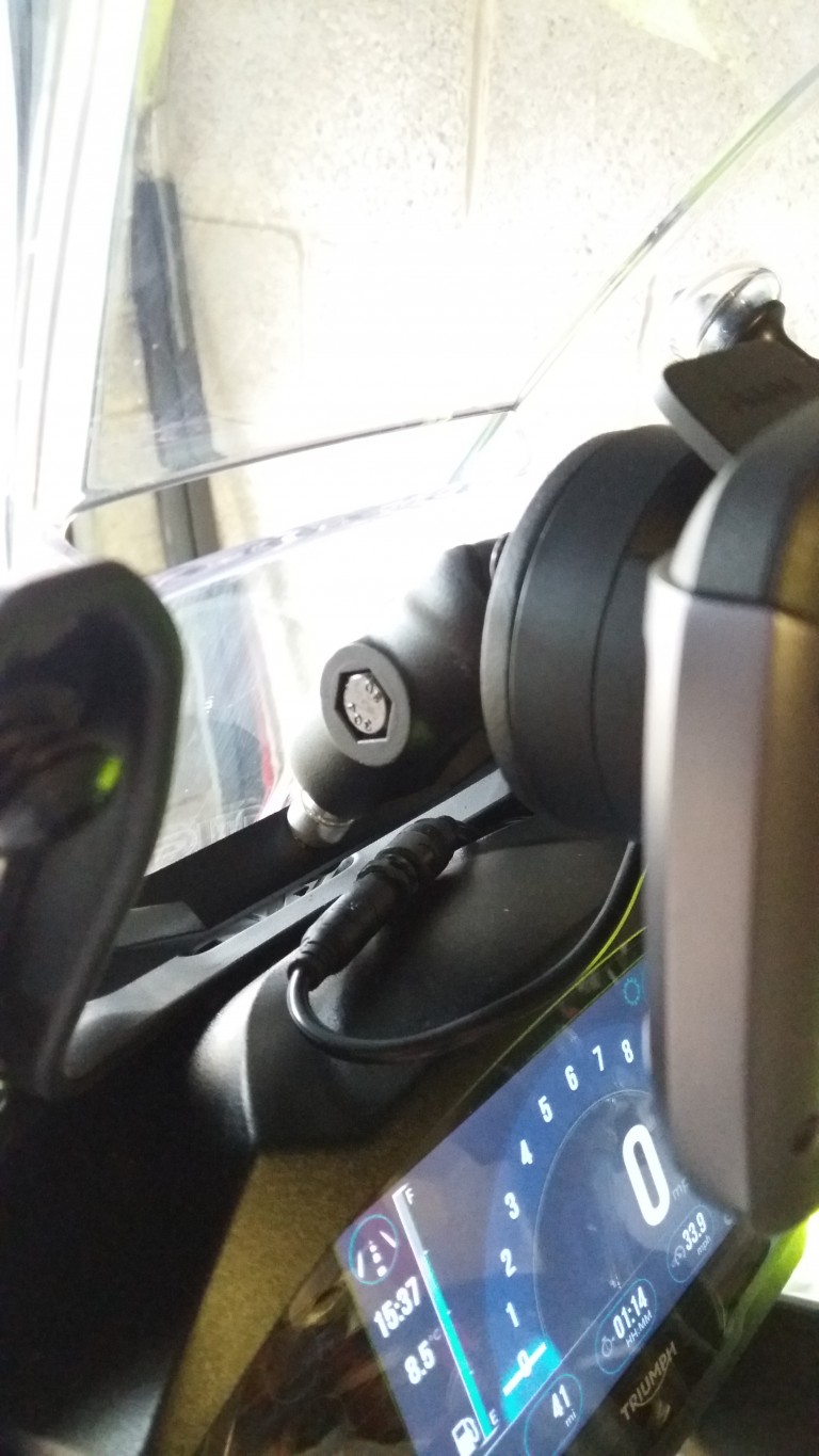

Finally found time to fit my bracket today, very pleased.
I copied Sprint (method 2) and tapped the bracket to take M6 bolts. Similarly I cut an M8 thread to take the Ram mount. The bolt was a bit long so I stuck a nut on the bottom to well and truly lock it off.
I am currently using my phone and the Scenic app for navigation hence the X-mount arrangement pictured.
I'd like to say a big thanks to Mike for sharing his ingenuity with us lot.
Also thanks to this forum which makes great things like this possible!

Fitting advice if you tap a thread in the SatNav Bracket or use small diameter screw heads or nuts.
As there is a lack of plastic to bolt to for the SatNav Bracket it requires a the maximum spread of pressure on what we have available.
My suggestions are always to put a large diamenter washer (Penny Washer)  if using a small diameter nut or screw against the supplied plastic washer. Use a bit of lubricant (my favourite is Petroleum Jelly) on the back of the nut or screw head, so the metal washer is used like a bearing when tightening. If tightening on the plastic washer without a large metal washer there is a chance the plastic washer may fracture in such a way as the screw or nut will pull through the plastic washer.
If you use a large diameter dome flanged screw it is still advisable if it is on the the inside and not against the Bracket as a screw thread has been tapped into the bracket. If using a larger diameter flanged large nut against the plastic washer it is more acceptable not to need a large diameter washer as it is best to turn the screw to tighten and leave the nut stationary.
Finally, do not overtighten the screw, not sure how much torque, I turn until i get no movement of the bracket and then tighten a small bit more so it does not come undone. Please do not use all your strength to tighten the screw.
If you are not sure always seek advice.
Anyone want to add anything or disagree?

« Reply #98 on: March 26, 2019, 04:39:06 PM »
Good point Mike.
I have now added a couple of large diameter washers as you suggested.
I have actually ordered some larger button head bolts (not here yet) and just used the bolts pictured as I happened to have them knocking around in the garage.
