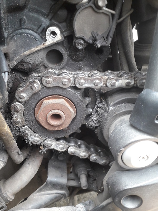

So, within the confines of my front garden bike bay. Front sprocket cover removed to reveal 2.5yrs worth (14k miles) of lube build up.
Sprocket nut didn't fight me thankfully. 36mm socket on my extending car wheel nut brace and sat on bike with rear brake applied made easy work of it. The front sprocket teeth were hooking forwards.
After a wash down with paraffin the new sprocket and chain fitted, nut torqued and lock tab re-used.

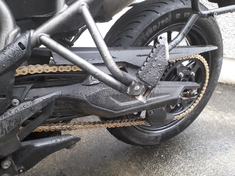

Unfortunately then the rain arrived as I started to remove the rear wheel but fortunately not too hard so I decided to carry on and get the job done today, so sprocket renewed and wheel all cleaned.  :017: :152:
As has been discussed, the 124 link chain on the roadie puts the adjusters well back in the slots before the wheels have even rolled. The lower back corner of the adjuster block is a mere 14.5mm from the end of the swingarm, leaving only 3 indicator pop marks showing.
After a few trips to work and the Gloucester Megemeet weekend, somewhere around 500-600 miles, I've just given the chain an adjust and lube before I go to work. Initial settling/stretch/wear (take your pick, we've had that discussion) had the adjuster winding out approx. 1.5 turns and the adjusters moving back just over 1mm at 13.22mm as measured in earlier post. I deliberately bought a spare link as a backup but also I plan at some point in the future adjustment to see if I can drop 2 links out and take the adjusters way back to the front of the slots?
