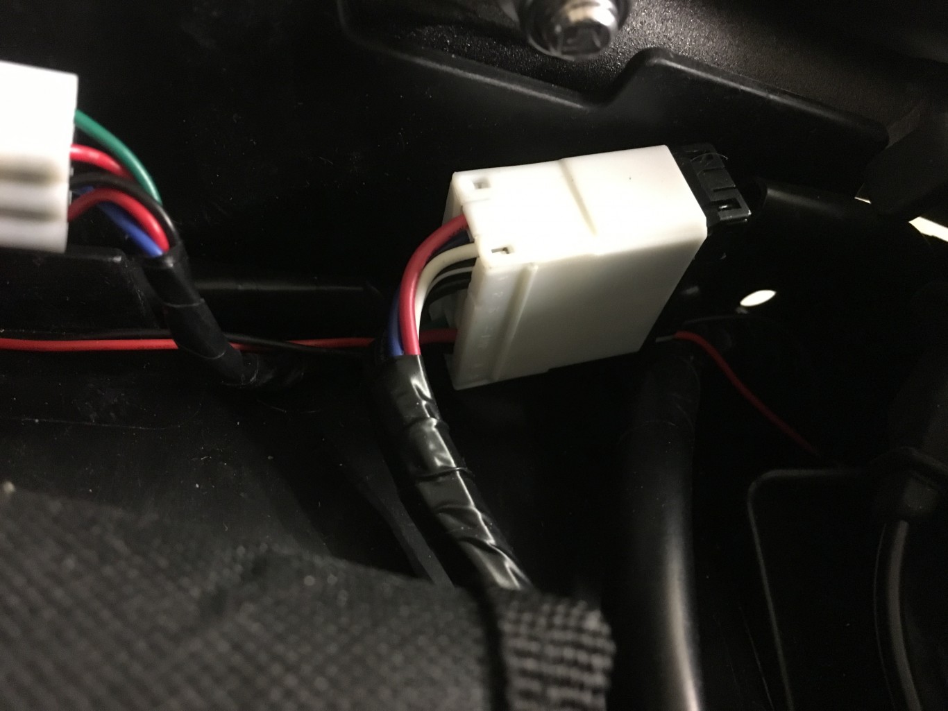

The 'Triumph' bit shown below however it's just an extension to the alarm loom with the required white Triumph connector at the other end. If anything the extra loom is a little too long at about 40cm but this would offer greater flexibility as to where to site the main control box
So one end snaps into the short lead from the alarm control box and the other end goes to this connector on the left hand side of the bike just ahead of the tool kit.

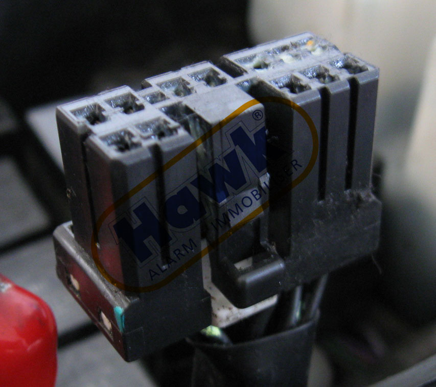

This is the Triumph connector you need to locate
And here's the Hawk loom connected and ready to go. I should point out that it's a good idea to disconnect the battery before connecting anything to your bikes electrical system

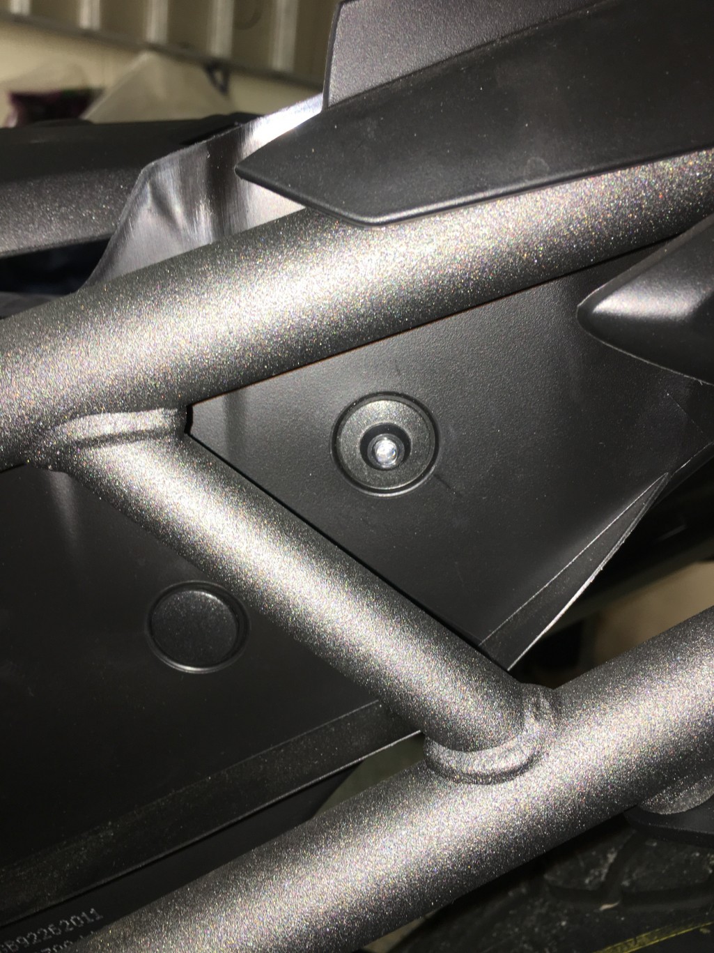

The final bit is and earth lead with a 6mm connector which needs to be earthed to the chassis using an existing bolt if possible. In my opinion this lead is too short and a few extra inches would give more fitting options. I found somewhere but it required more head scratching than it should. You can of course easily extend the cable if necessary

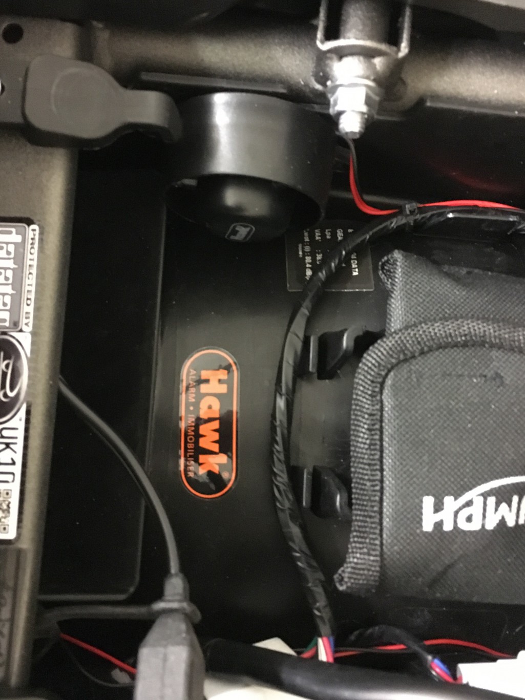

More time was spent trying to find suitable flat surfaces to mount the control box and siren. Both are very compact which helps a lot. For the main box,
I followed Triumphs lead and mounted it under the plastic carrier plate. This comes off with just 4 bolts and reveals a handy area but very busy with cabling. Unlike the Triumph system which bolts on, the Hawk alarm is light enough to attached with the self adhesive rubber pad fitted to the back. Although only  about 2/3rds the size of a packet of cigarettes, it was surprisingly tricky to find a flat area in amongst the curved plastics and wiring harnesses.
In the end I mounted it vertically behind the rear light cluster
After degeasing the plastics it stuck like the proverbial - best test the position with the backing paper still attached until you find the right spot. There are screw / bolt mounting points if you wish. I used one of them to run a loop of plastic covered stainless wire around the chassis to make it harder for a thief to remove. Probably does nothing but it made me feel better.

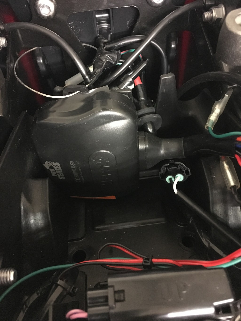

After that it was the siren - much easier IMO.
I found a handy spot just ahead and to the right of the tool kit. Again you can bolt/screw but I just opted to use the fitted sticky pad.

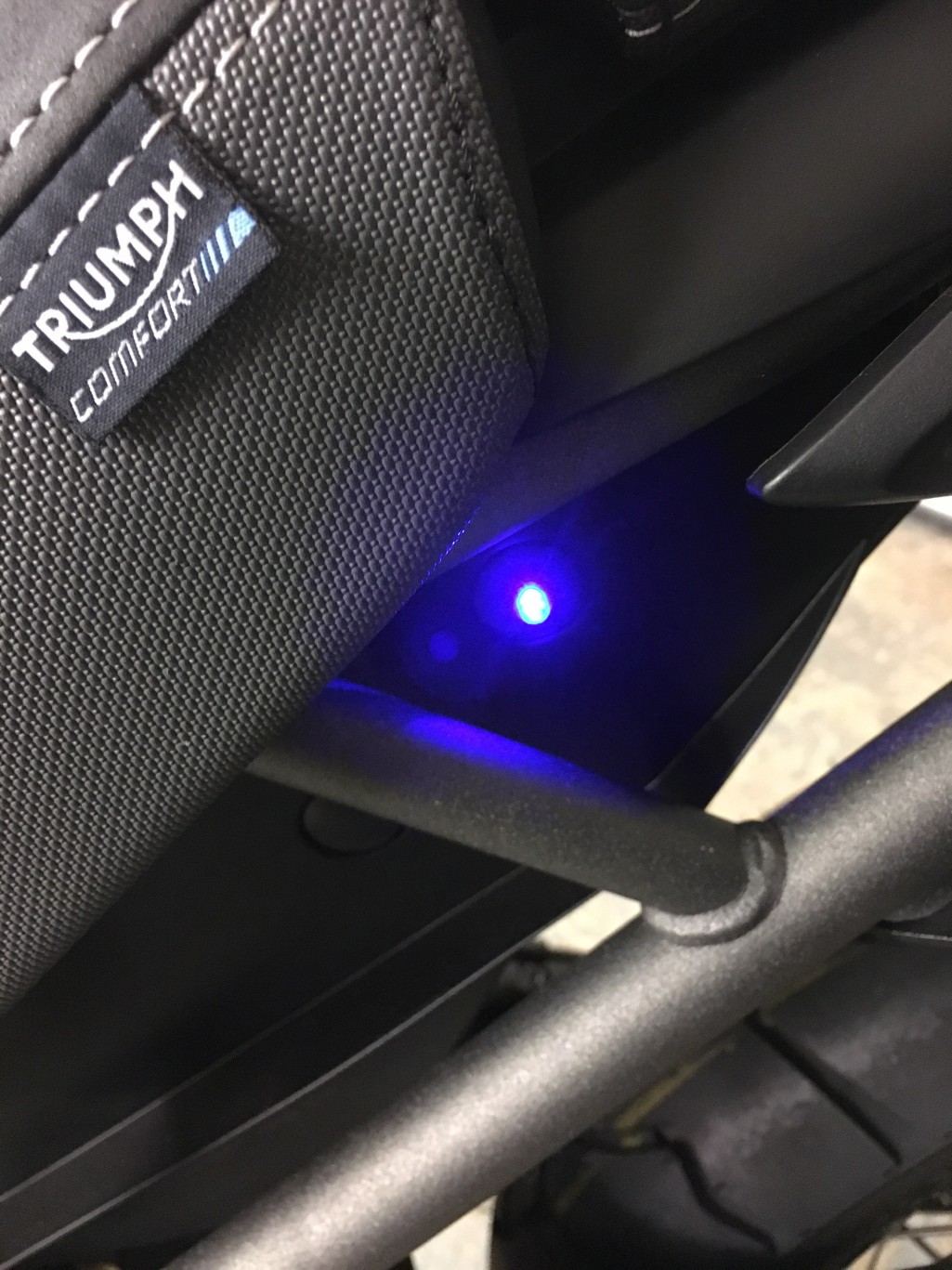

The last bit is finding a spot for the LED lamp. It serves several purposes - as a warning to low lives and also as a way of alerting the owner to any activations that may have happened since arming. There are various codes that will flash up when disarmed and also provides a method to enter a PIN number (user selectable) to disarm if there's been an issue with the unit.
The triumph alarm uses the red flashing light on the TFT display however it seems this is an issue for other brands. Personally I like having two lights blinking away - it looks more tooled up for the cautious thief.
Again I couldn't easily locate a handy spot that was visible but didn't require a hole be drilled in my new bike. Hawk Alarms suggested tie-wrapping it to the chassis where it could glow in the labyrinth of dark spaces of the tank area. In the end I decided to remove one of the two accessory power socket blanking plugs and drill a 9.5 / 10 mm hole on the centre. Magic - if I remove the alarm I can changed the bung and all is good again!
