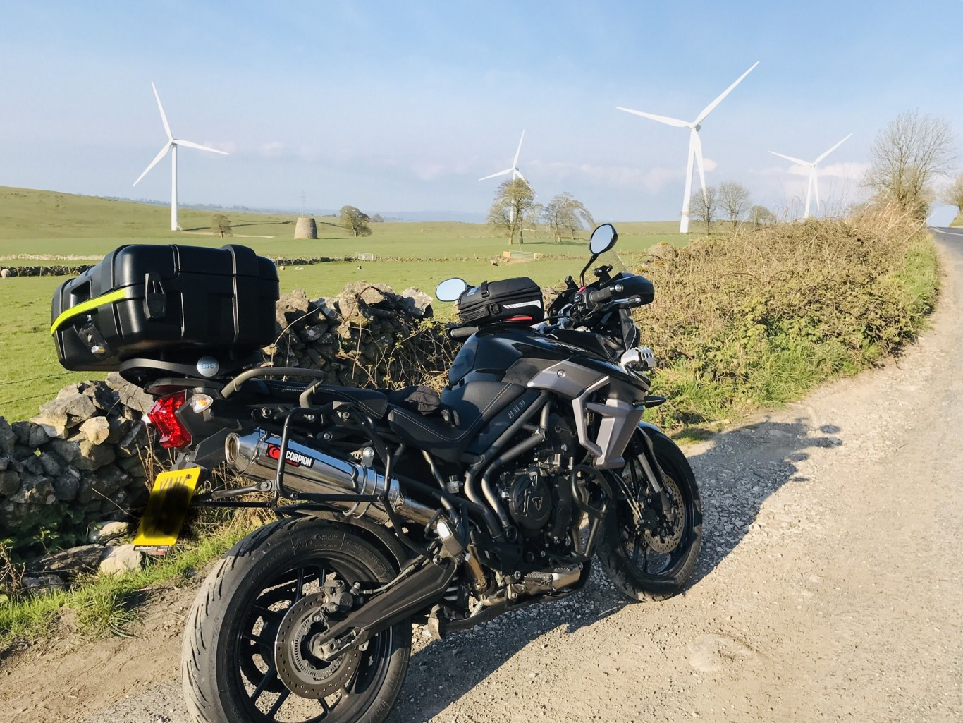

Good morning,
Yesterday I performed the 12 min ECU reset following an end can change.
After a ride this morning here are my thoughts:
Idle is much more consistent, less hunting.
Throttle seems more responsive.
Seems to accelerate cleaner.
Exhaust note possibly a little fruitier.
All in all the bike is feeling sorted. Im not if the final point above is true, or the placebo effect!
Anyway, heres a pic from the ride :)

Nice looking Tiger! - Does this reset work on all models/years? (I have a very early 2010 XC model)
