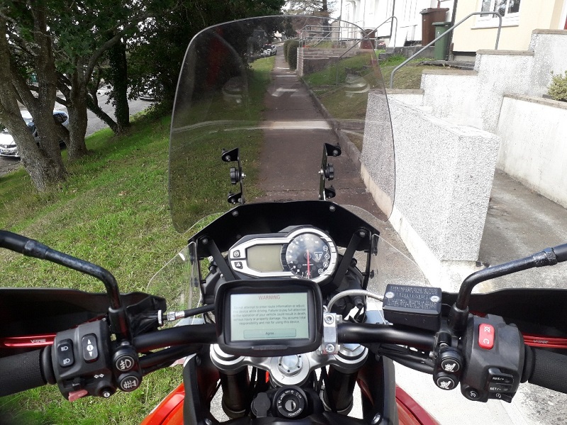

Hopefully the weather will still be good Wednesday when I've finished current work block and I can get it fitted. :017:
Well, a week later than hoped but in decent sunshine fitted my new bracket this afternoon.  :028:
Zumo 390 as fitted to standard XRt supplied handlebar bracket .
. and relocated on new bracket .
though wasn't the plain sailing I expected. The hole in the bracket wasn't quite big enough to allow the power connector to fit through and as 13mm is the biggest drill bit my drill can take I had to resort to a round file and enlarge the hole and touch back up with a dab of black paint.
Still needs a tweak as the position of the power box tight against the air filter snorkel gave enough power cable that everything was fine lock to lock but when I finally parked the bike on sidestand with steering lock on I noticed that the cable then became taught (so currently parked with steering straight). Hopefully I'll find somewhere easy to move the box forward a couple of inches but don't ideally want to put it against the cylinder head and excess heat.

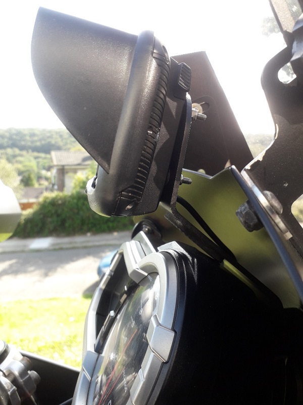

UPDATE & FITTING TIP:  Went for a little 120 mile ride Saturday (had a specific task) and immediately wasn't impressed, the Satnav was bouncing around like a jelly ...... but I immediatelly realised it was my own fault. If you (can) zoom in on the side view picture you will see that the foam/rubber pad is not quite touching the instrument housing. When fitting the new bracket I inserted it between the ambient temperature probe and Madstad brackets. At my destination (couldn't be bothered to stop before) I was able to get a piece of cardboard box and slide it between instrument housing and bracket, slightly applying a small bit of tension on the bracket to eliminate the possibility of vibration/movement. On the return journey the Satnav was rock solid. :028:
So, the pad isn't there to avoid rubbing but essential to a stable Satnav,  I just need to reposition the bracket innermost directly against the instrument back housing and take a short test ride. If there is any movement/vibration it will simply need an extra piece of very thin foam/tape added to the existing pad. :017:

Hi Steve
As you said the rubber cushion needs to be sat on the clock housing. This will stop any vibration and blurred vision. Sometimes the bracket may need slightly bending more to achieve this. Or as you have also said adding another piece of thicker rubber will also have the same effect. I will be adding an extra cushion pad to future orders and fitting instructions. Ride safe mate
