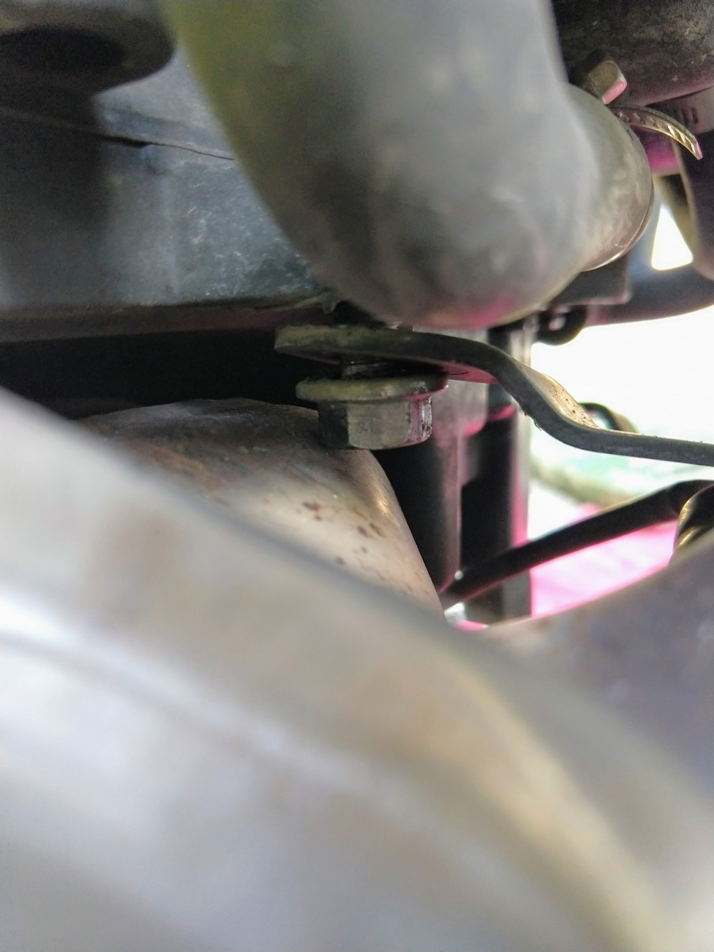

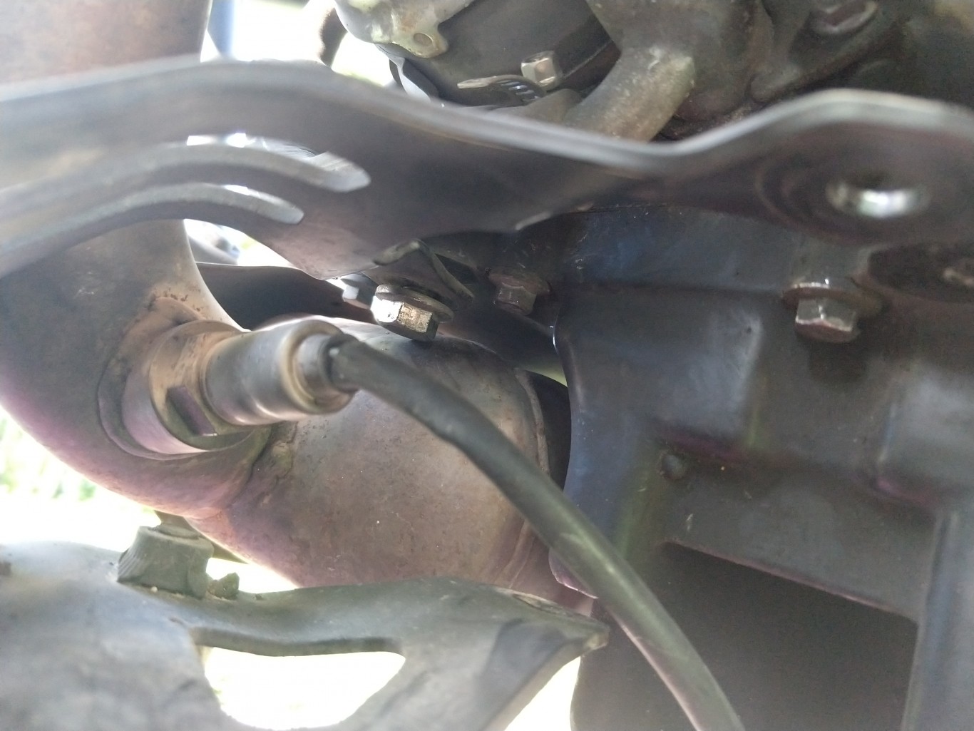

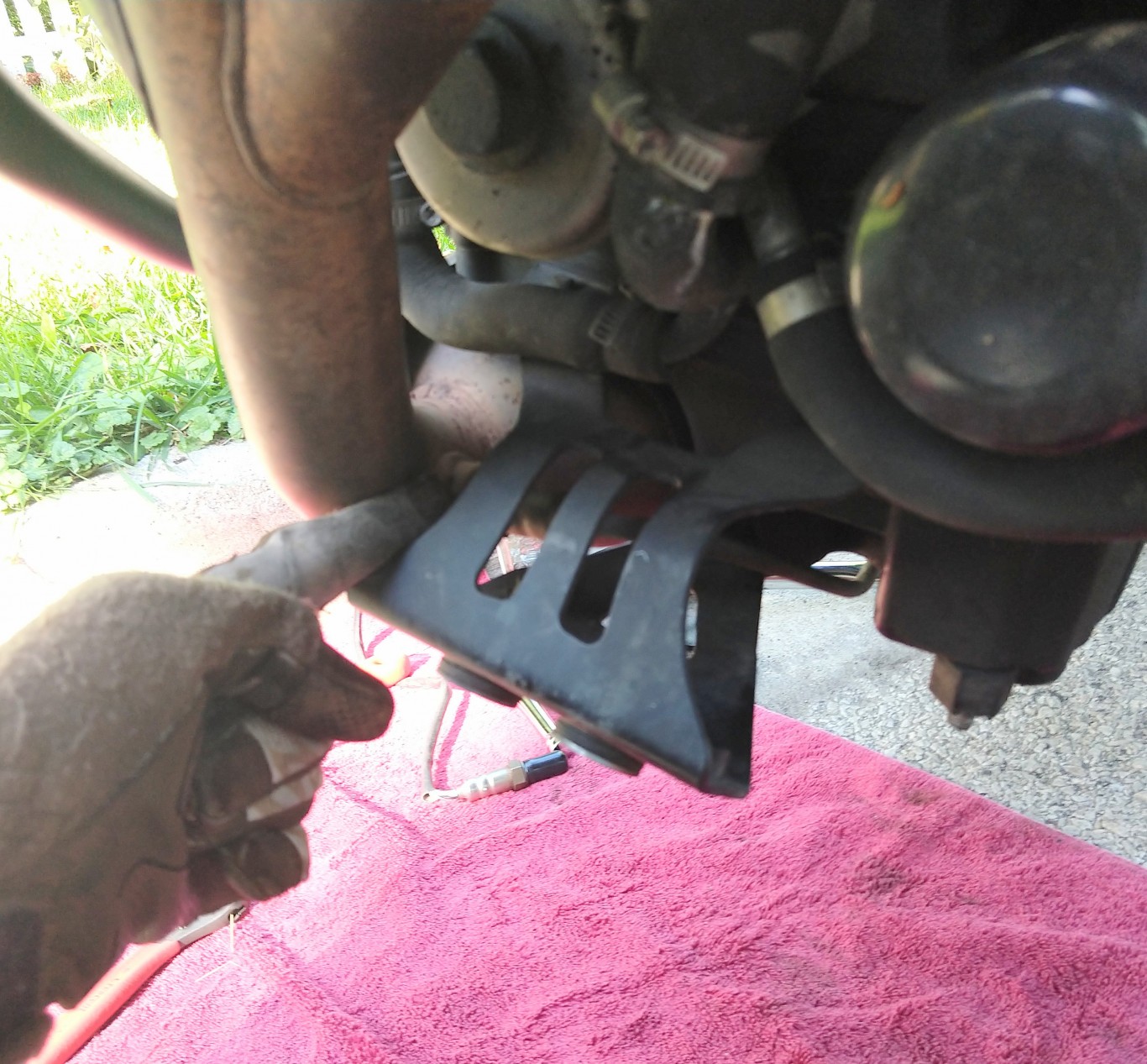

Greetings all - a little help appreciated here from someone who does not have a lot of tools or motorbike knowledge.  Bought a new O2 sensor from here: https://www.mechanicsurplus.com/products/142796013 and today dove in to replace the old sensor on my Tiger.
My question: How on gods green earth do you get this plate off (see pic) ?!?  :157: The bolt closest to the exhaust looks seems like it won't be able to be removed due to the proximity to the exhaust itself.
If it does come off, what kind of tool gets in there?  I used a spanner to widge it one 1/4 turn at a time, don't even ask how long that took.  :087: Now it needs a bit more elbow grease and there simply is not room (and when I do get it off, how the f to get it back on without spending 3/4 of a day on it?!?).
If I can remove the old O2 sensor without removing this plate please do tell - but again, there is no room to do so as it stands.
TIA for any advice.

Just to update:  Gave up and took the bike to my mechanic, who had a tool (of course he did) that could reach in to remove the O2 sensor and replace without removing the black plate. Bike is quite a bit smoother, if that's possible, or is it all in my head..??
Also, the part from Mechanics Surplus is NOT an exact match, FWIW... slightly different.  It still fit, and hopefully the bike won't start throwing a code again.
