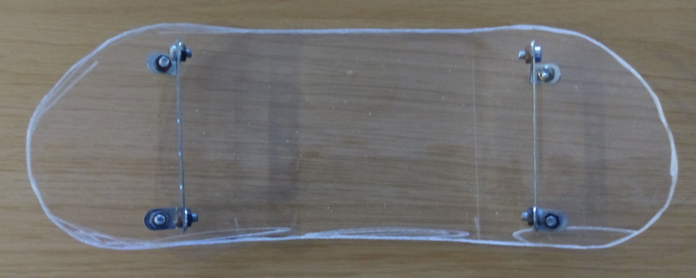

I had a 2017 XRT with adjustable screen and buffetting was pretty bad up to about 80mph and OK above (speeding is not a good long term solution).
I bought a second hand screen and tried out the theory that lower was better, by cutting it down a bit then a bit more until it was just above the clocks, which it was, as the buffetting then disappeared, however was replaced by wind pressure (Ok at low speed but not at higher).
I eventually bought some plexiglass off ebay and made a deflector based on dimensions from internet pictures. Mounts made with meccano and shaped using a heat gun and bending in a vice. Covered the screen with masking tape to avoid scratches and attached with more tape to mimic the positions available. See pic.
The conclusion was that the deflector worked as the best compromise with a mid screen position, so I purchased an MRA version.
The few times I have been on the 2018 Tiger I have just put the screen low, but did notice some buffetting. I would make a DIY deflector again before purchasing as sending back can be difficult.
