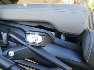

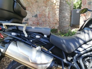

Pillion in a Million complained about sliding when under brakes and bumpy road sections.  My quick fix is a follows.
Door stopper trial in white ended up with 30mm black stoppers.  Fixed the stopper to the plastic frame on the bike. The front brackets of the pillion seat slide up under the seat not the wire style loops. The main seat which is in the low position.  This gives a level pillion seat, Pillion Million is now happy.
Hope I havent repeated someone else work apologies if so.
Rubber side down the only way to travel!

Hi not really worried about water as there is no seal on the seat to seat joint it self I also live in a dry area.  I do plan add a skirt around the pillion seat to obstruct view more for security.
