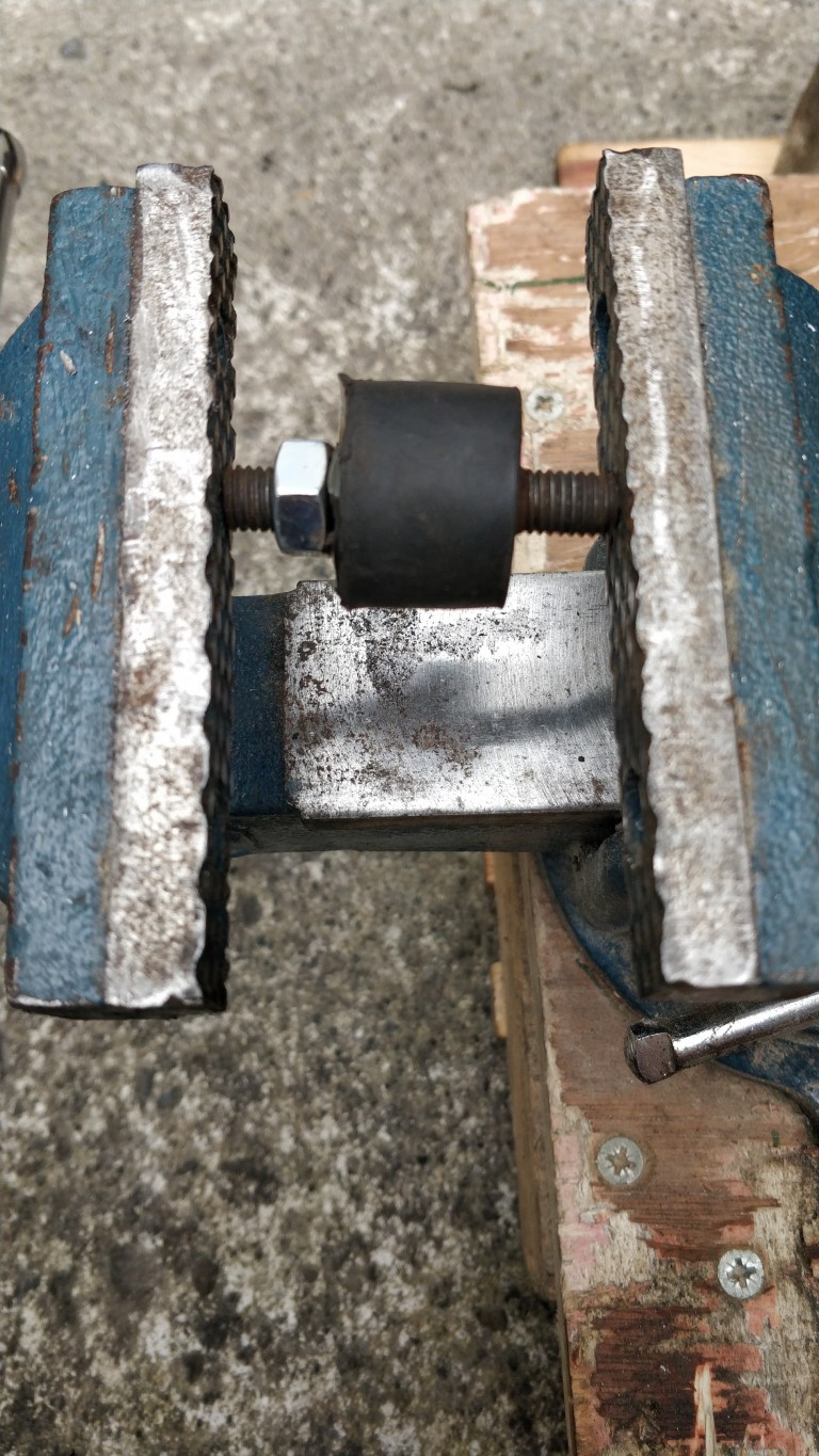

Stripped the suspension to clean and re-grease  prior to the HyperPro arriving Tuesday. Found x3 of the anti vib mounts broken - x2 Triumph and x1 aftermarket. The triumph ones are toast. Only had 2 new so decided to clean up and reglue the aftermarket. I used Gorilla glue. You need to wet one surface to activate it. Left it in the vice for a couple of hours to set.
Mounts
Repair

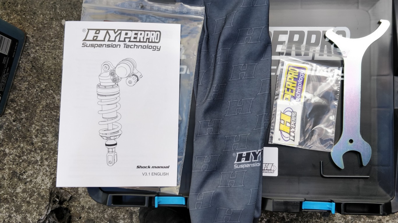

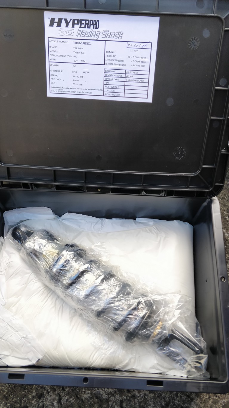

Stuff inside box
The shock itself.

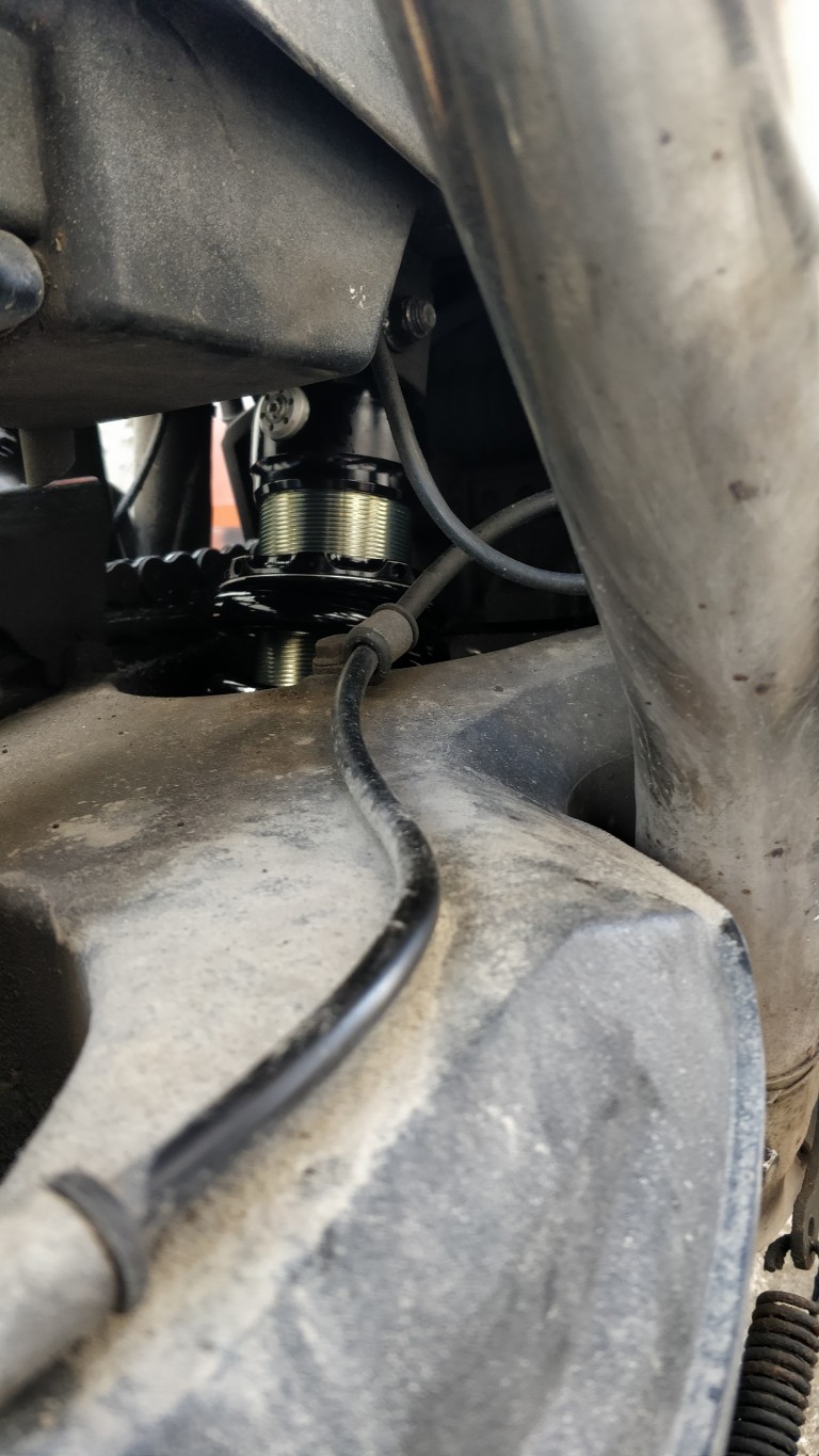

Fitted - top
Fitted - bottom
