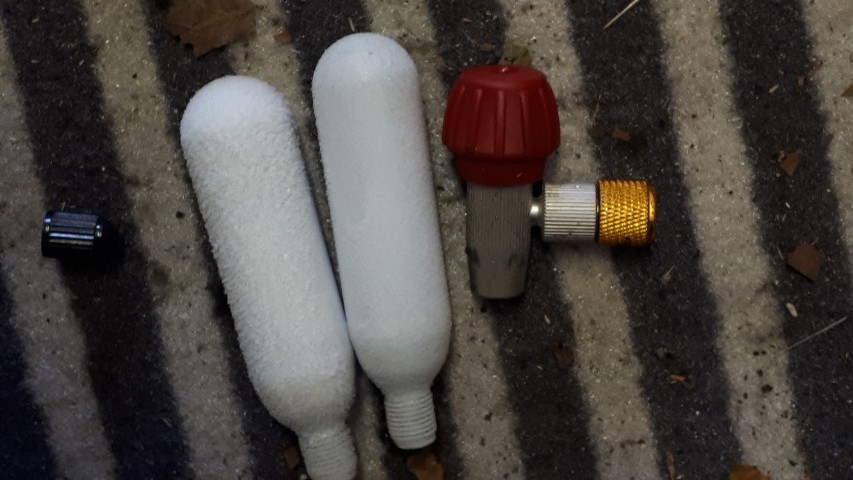

I'm pretty confident that a properly installed vulcanised plug is a safe option.
Stop'n'Go instruction says to travel no more than 100 miles at speed below 50mph so they're covered.
I did run on a SnG plugged tyre a couple of years ago (different bike) from Girvan to Galway and back to Edinburgh with no mishaps. Got a permanent plug installed when I was back home.
It wasn't a screw this time.
No idea what kind of nail it is.
I was going to try and repair using only tools in the bike.
Failed there. Had to resort to this nipper tool:
Although the SnG plugs are lubed I had to use a dab of red rubber grease to get it rammed in.
So need to take some in the toolkit.
Used two CO2 bulbs to get to 11 psi then electric pump.
Inflated to 42 psi and pulled on the rubber tab.
See how it holds pressure over the weekend.
Wonder whether riding the bike makes it a better or worse seal? A bit of centripetal force might make the plug more secure.

No luck with this plug. Pressure down to 29psi overnight.
Trip to mechanic next week.
