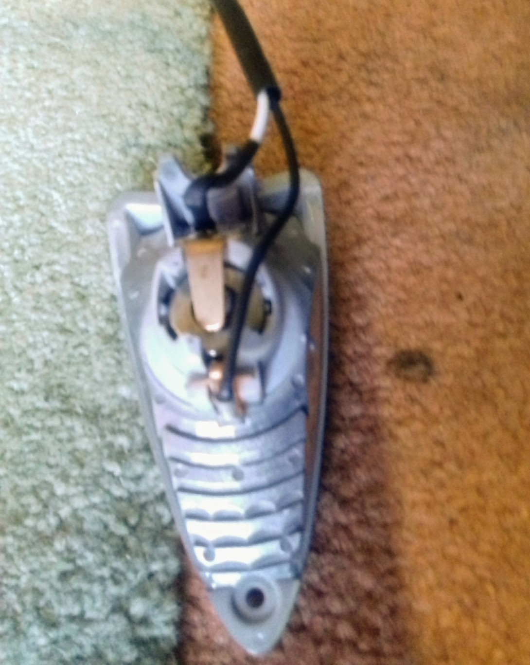

Remove the Beak & 2 side panels  - see Muddy sump video tank removal.
Disconnect & remove indicator.
Remove clear lens - tiny Philips screwdriver required.
Pop out reflector and bulb housing from indicator shell.
Disconnect 2 wires - black offside , white inside.
The cable with these 2 small flat connectors will fit through the indicator and stalk hole.
Fit new stalk & re-assemble.

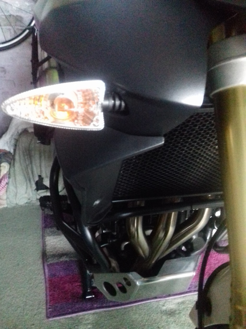

See photo as just fitted today
Good as new  for 4.95, and don't go down that path of aftermarket tat  :001:
