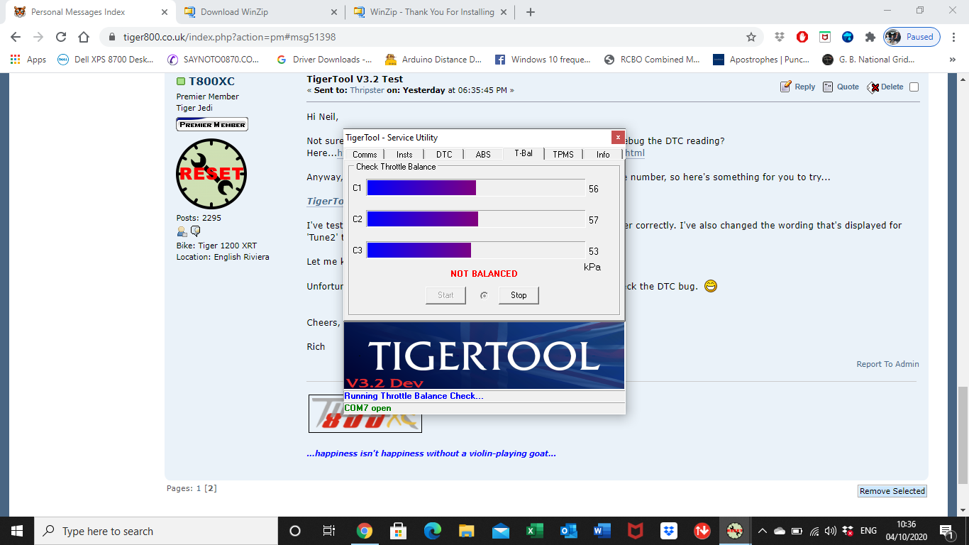

Hello folks, wondered whether I could tap you for your experience please for a Tiger 800 XRT first registered 22/08/2019 and which I bought on 13/02/2020 with 748 miles on it. The ODO now shows 3400 miles odd.
The pictures show carburettor balance using Tigertool.
28th August 2020
4th October 2020
I feel that my bike is developing a progressively worse misfire. Evidence for this is: (i) a faltering performance particularly when cruising in third or fourth gear at any revs between about 2500 rpm and 4000 rpm (ii) erratic rev counter reading at idle (iii) Intermittent stalling when pulling away.  The above two pictures show the carburettor balance on the dates shown. I have the following questions, as shown below:-
(1) (This is probably for T800XC). The cylinder numbers are shown C1,C2 & C3 on the balance cylinder print out......as you sit on the bike is C1 the left hand pot, C2 the middle pot and C3 the right hand pot?
(2) Given that the balance on cylinder C3 seems to be getting progressively worse, am I better trying to rebalance the carburettors first or searching for another reason for the misfire first? Have perused the forum extensively, it would seem to me that either (a) there is a suspect ignition coil (pack) or (b) there is a problem with the interface between carburettor manifold and engine block possibly letting air in.
Thanks for any insight you can give on this.

I agree .... contact the dealer. It could be simple bad ajustment,  bad sensor(s), manifold leaks as has been reported here, or other?
The 1st time I used Tigertool, years ago, these were my cold engine readings.
These were recently beta testing v3 where I rode the bike until normal working temperature first before running Tigertool ....

Composed a previous post which seems to have disappeared, so here it is again. Emailed Muddy Sump wrt to throttle balance and he asked whether I had warmed the bike properly. Balance check picture after fifteen minutes is a lot better (I had only run for about five minutes previously - stupid me) but note that whilst running the image is repeatedly changing from balance to out of balance.
