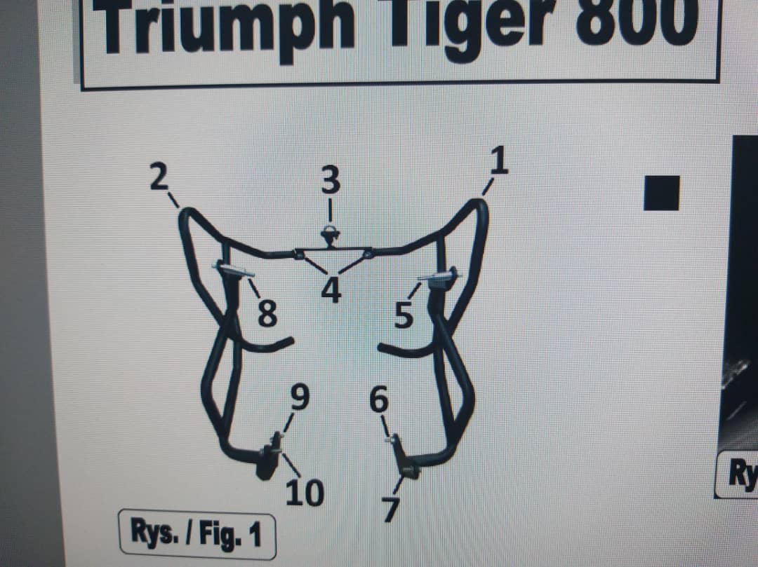

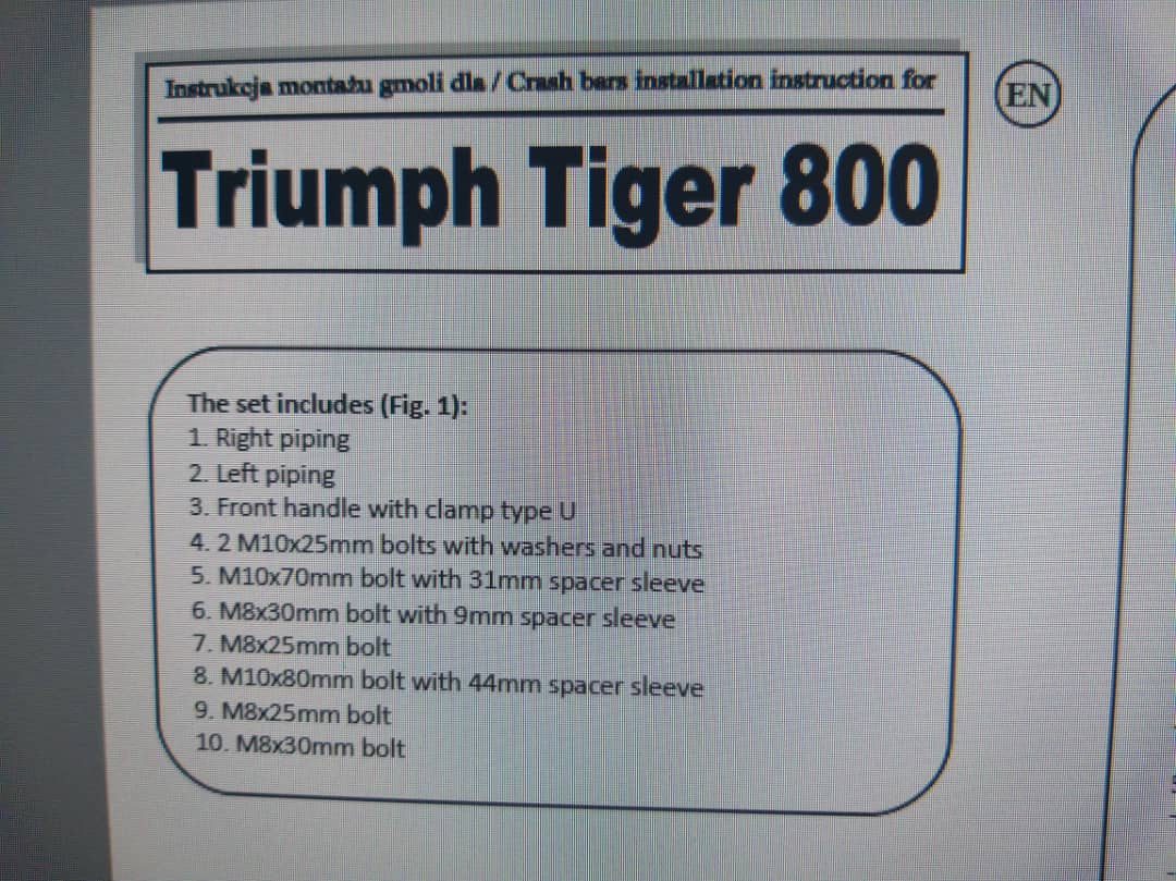

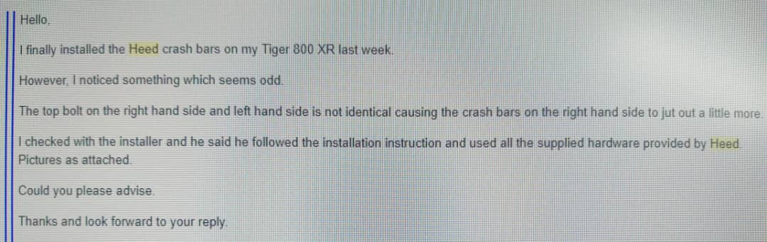

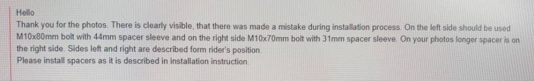

The HEED bars come with their own bolts/spacers and it seems that the spacers are location specific.
It was installed by the local dealer and assumed that the RH & LH spacers that came with the HEED bars were the same length.
I was wondering why the RH side bolt stuck out and it made riding uncomfortable.
I then checked the instructions and emailed HEED Poland and they advised me to swap the spacers.
Please see attached my email correspondence with HEED and the installation instructions. Email addresses were removed.
Take note of #5 & #8 on the installation instructions.
Hope that helps!
