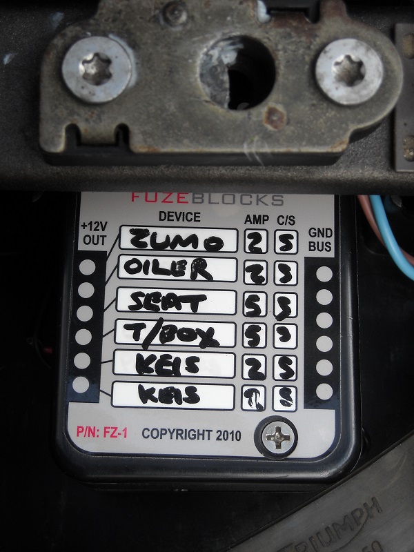

Looking at the Thunderbox the main thing that I notice is that while it has 16A capacity and overcurrent protection you simply connect all auxiliaries to the same feed without any actual circuit protection to each accessory.
For example with the Fuzeblock system I have each circuit can be protected by any mix to the requirement of the accessory on either a constant or ignition fed supply.
