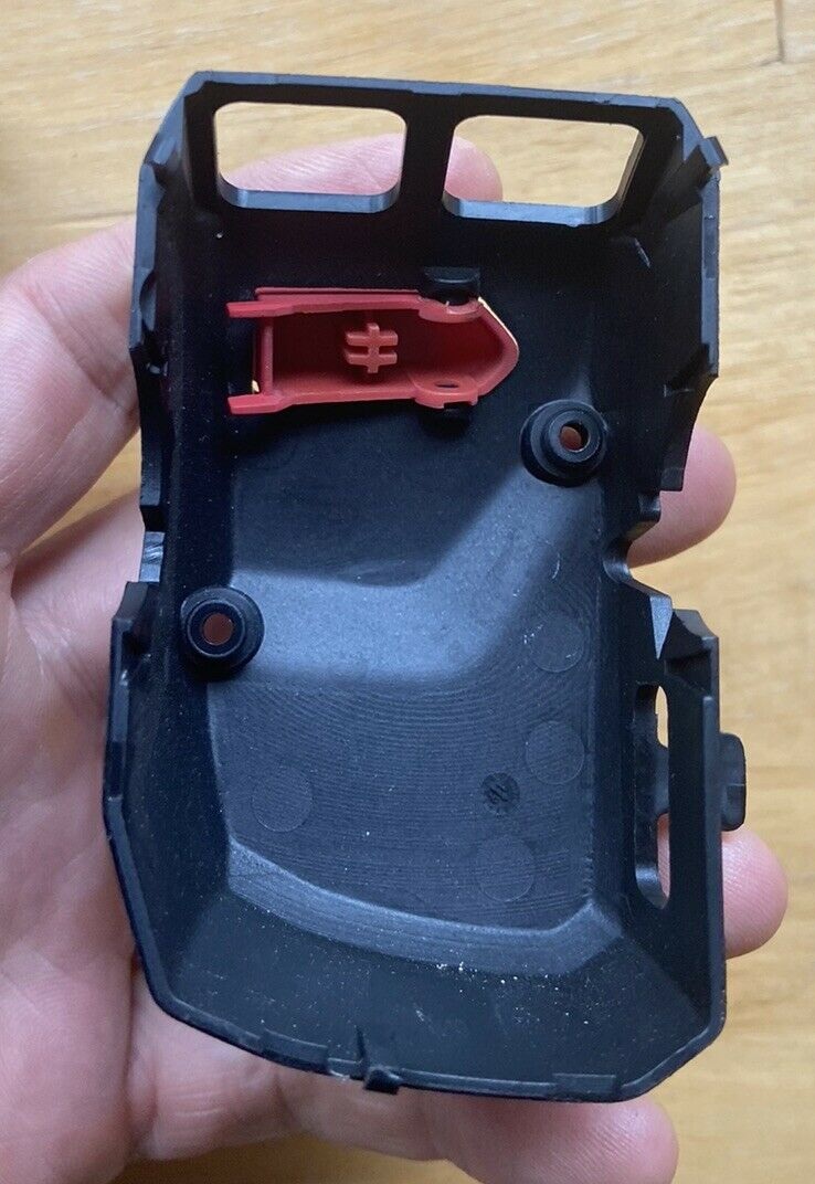

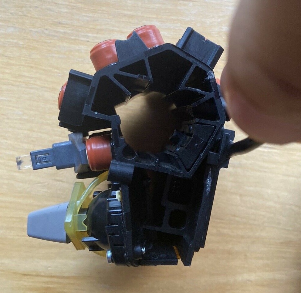

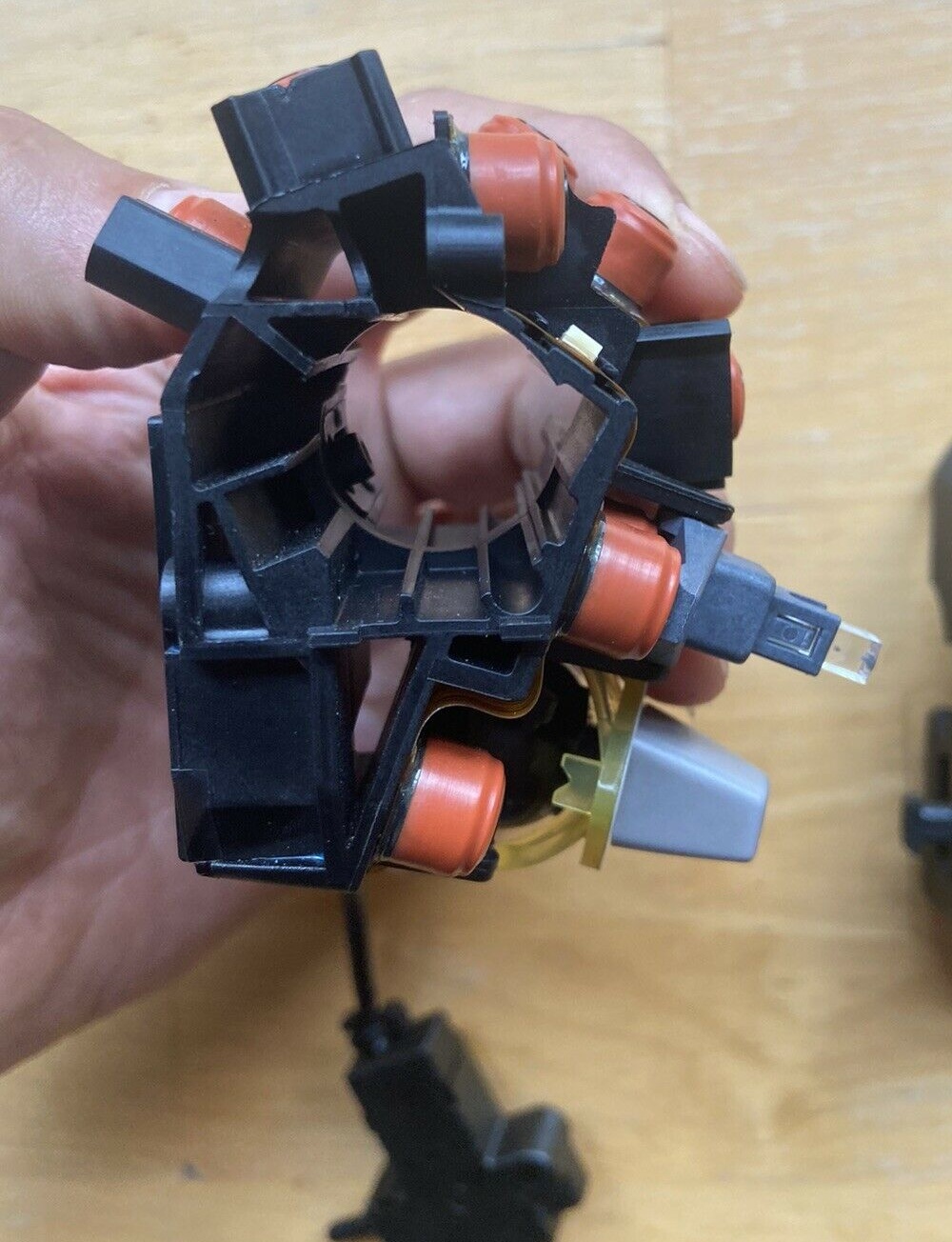

I tried to remove the LH switch gear the other day on my 900 to change the handlebars but gave up,  I did get the top section of the cover off but as I have the heated grips I would have disconnect the cabling that goes under the tank some where?
I have found a few photos since and it seems that there is location pin that you have to lift up to slide the unit off the bars there is a triumph tool to do this or a small flat blade may do it, looking at the lack of information it seems that there ae not many problems with this switch gear it was also used on the last version of the 800 and 1200.

I just found this USA recall notice that shows how to remove the LH switchgear.
https://static.nhtsa.gov/odi/rcl/2018/RCSB-18V302-5493.pdf
