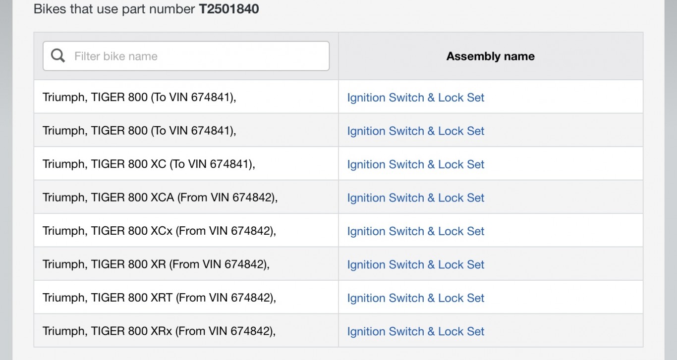

Well it looks like swapping the new antenna ring onto the old ignition switch has done the trick.
Took the bike for a long ride today to get it nice and hot.  Parked it back at home and checked it every 30 minutes or so for the next couple of hours and the immobiliser disarmed no problem.
So, for anybody else who finds themselves with the same issue and doesnt want to replace lots of components and get new keys encoded, Id recommend you try this.
The same ignition switch assembly part number is used on all of these Tiger models:
