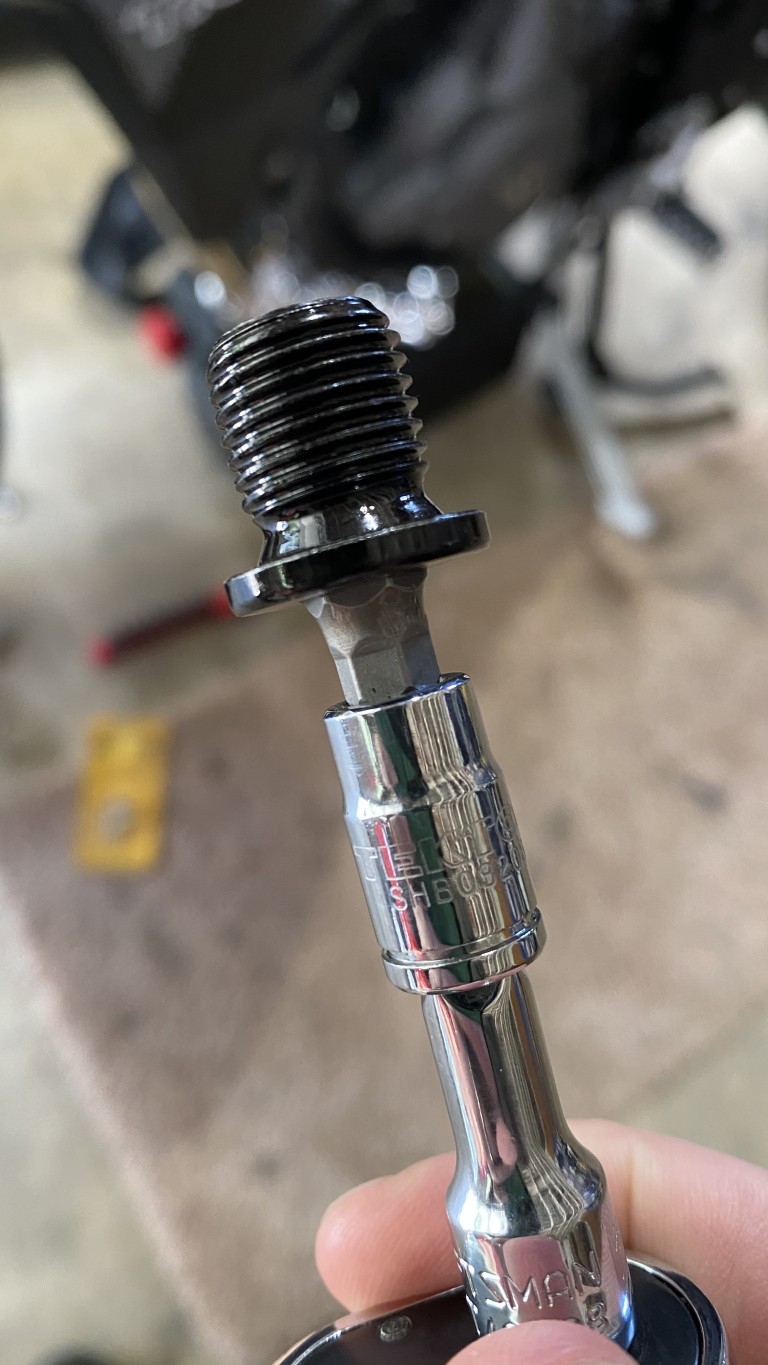

This is what the plug looks like, it is larger diameter than the one on the 800 but same depth and same crush washer.
I usually replace the standard plug with a magnetic one but I dont have the right size.  So I will order one and do that next oil change.
Lesson:  I expected to see a grey Allen head, saw black round and thought it was the wrong thing.  Didnt check the hole.  Surface is round, but bottom is hex key M8.  Problem sorted, oil changed.   :016:

That looks weird. I've never seen one like that.
Edit: Woop you figured it out and it looks like the original one on my 800.
