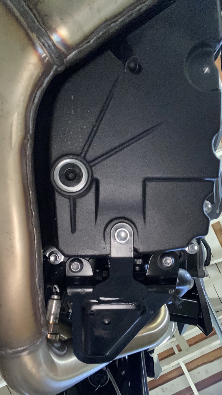

Ok, Gents mine must be really strange.  This is after I removed the the skid plate.  The forward bolt is holding on a bracket that the skid plate connects to, and this circle thing has to be the oil drain plug.  Bizarre.
There is a hole in the skid plate to get to that spot, so it would make sense to me.  It is perfectly round at the bottom but has an Allen key at the base, the online manual shows that is the right spot.   An M8 key does fit up in it, just didnt look like what I was expecting.
I was literally handed my keys and told the bike was out back in the alley when I picked it up.  To be fair it was after closing.  I emailed the sales guy today and he said he has a backpack for me when I come in for first service.  So they would normally have given me a manual.
So apparently you do NOT have to remove the skid plate, although it makes getting the oil filter off easier and maybe you will make less of a mess.
