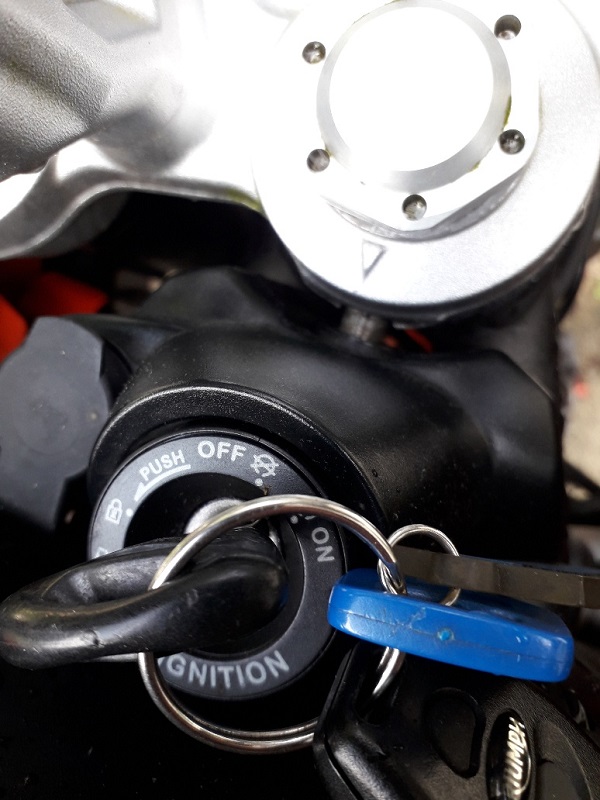

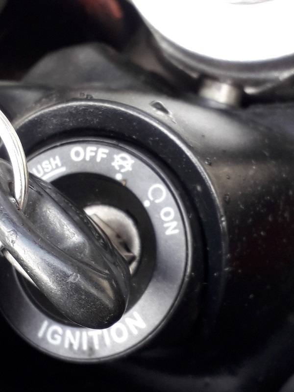

I have just gone out and looked at mine. A hard position to picture with a phone, but ...
... here, obviously is the key in 'Off' position ...
... and her I moved towards 'lock' until front of lock pin level with hole entrance. The key points to the 'P' of 'Push'.
I then cleaned the lock pin off and, as best as possible, marked a line as tight as possible to the back end ...
... and when turned to the 'Lock' position the whole of that marker pen line just goes inside the locating hole .... around 10mm I would estimate.

I've just took the bike out of its restrictive parking bay in my garden to use and quickly played with the lock and noticed, something I never use, that when moved to 'Park' the locking pin moves even further forward ... maybe 4 or 5mm.

Hi. Stevie P. Thanks for the trouble you have went to. I am the second owner. The only damage is from myself at the top yoke due to the pin.  in just the lock position like normal people would do to check that the lock has engaged ( not forcefully tried by the way ) and yes if as your pic. Shows when I turn to the park position the pin travels a lot further into the hole and is very secure its when in the lock position ( yes if you try to turn the bars straight the lock pin does it job but if I first turn the bars left then  to the right the lock is useless 🙁

From the OFF position turning the key anti-clock pushes the locking bolt into the yoke (arrow lined up of course); not sure why the inscription on the ignition says PUSH, cos that has no effect. Continuing to turn the key further (park position), pushes the locking bolt an additional 5mm (ish) into the yoke. Thats all very well, giving extra insertion (on-er misses), but that puts the parking lights on, which is not needed.
