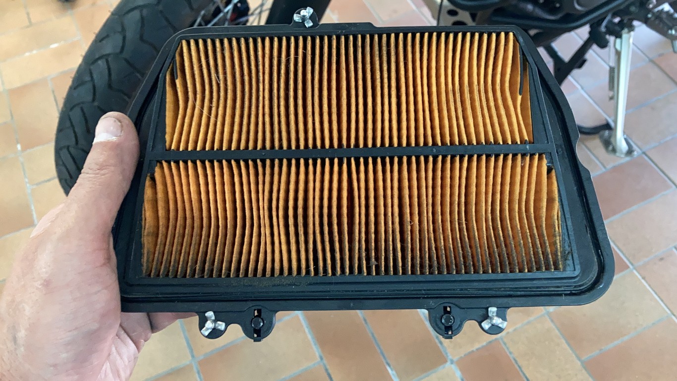

2) Air - Bike was serviced in November ready for Winter and the air filter looks reasonably clean. Bike only has 5500km and has been dealer serviced twice i that time due to my preference for fresh oil over the winter lay up. I dont think thats an issue

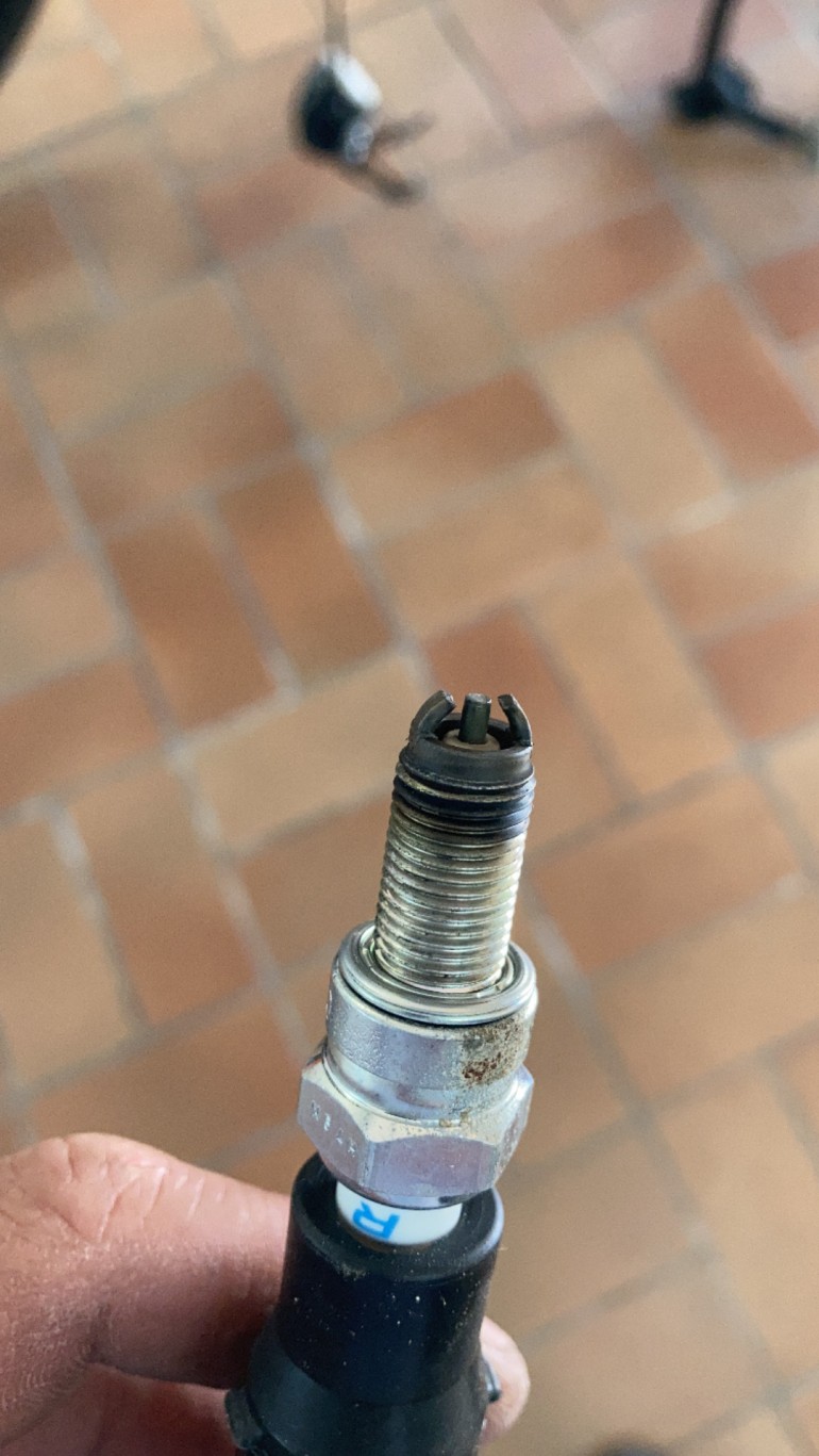

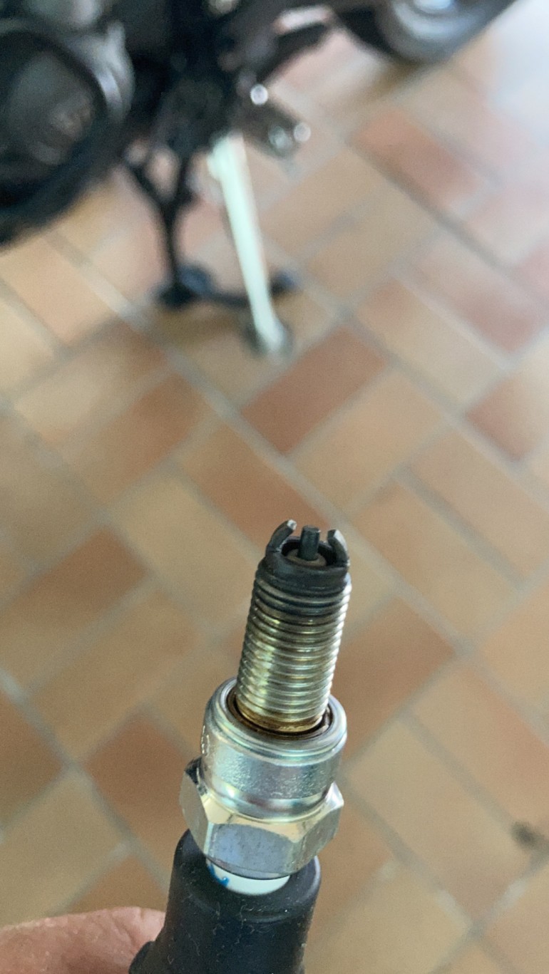

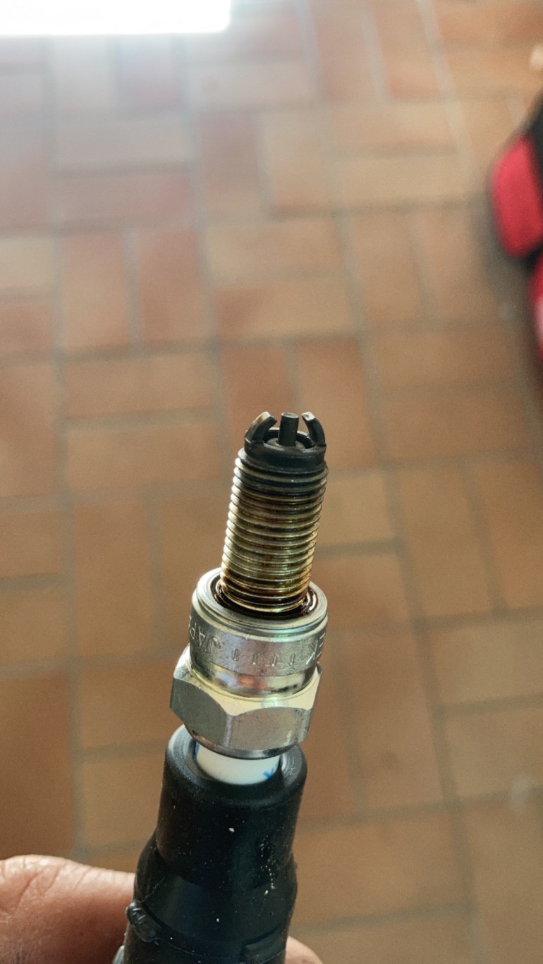

I stripped the bike plastics and tank off. No loose wires or hoses. No blockages in the Snorkel. So I removed the coils and plugs.
Plugs have no continuity between the core and outer metal parts and resistance is 4.6, 4.6 & 5.3k ohms. NGK CR9 plugs have a 5k suppressing resister. Now they are out I will change then anyway.
