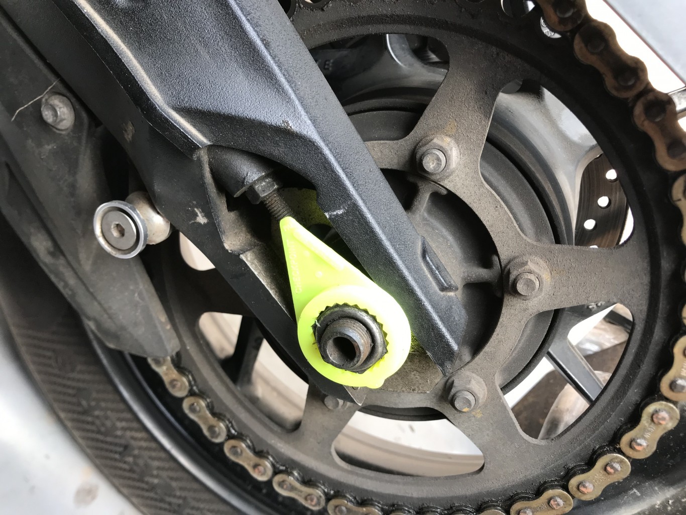

Thanks guys. Just as I thought: Reusing the lock-nuts is normal and no-one seems to have had any trouble with that. It just bothers me that the front spindle has two clamp bolts to stop it coming loose and the rear spindle has nothing, not even a good old castellated nut with a split pin.....
I got one of these from a mate with a truck that has 27mm wheelnuts. What do you think (I'll spray it black of course)....? Easier than taking a torque wrench on long trips into the back of beyond!

Rear torqued to 110nm. I've yet to see one loosen but hayho every day is a school day.

I think using a so-called Wheel Nut Indicator (WNI) is quite a good idea because, as indicated, it provides you with an instant indication of whether the nut has moved however unlikely! That said, a spot of black or white paint at the nut 9 o'clock position might be sufficient and is certainly something I will consider doing :084:

re-use, torque, and a dab of paint on the frame and nut to provide a visual reference - been doing that for years without any hassles
