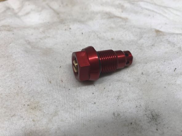

    I've gotten the Ktech valves fitted. Fitted .8 kg/mm springs at the same time. There is nothing particularly difficult about it but there are measurements that need to be taken, a couple of things that aren't obvious required for disassembly and some special tools that make it easier but are not mandatory. All this is available on line. The only thing I found a little hard was getting the seal reseated. I don't have a special installation tool so I ended up splitting the old seal, wrapping around the tube and using it as an installation aid. Like lots of other things the second fork went twice as fast as the first.
    I've only taken a couple of rides around town. The edges on the bumps are definitely smoother. Bigger holes are not cushy. We're heading up to Colorado this weekend so I'll get a chance to see if there are any handling quirks. I preloaded the springs 30mm and haven't taken the time to measure the sag.
    I've attached a picture of the old and new base valves. There must be a low speed bleed hole on the Showa unit somewhere but for the life of me I can't find it. The base diameter support on the Ktech unit is much smaller so it will be softer.
    They were nice enough to include one of flow control valves (clicker) but it doesn't seem to go anywhere. It looks like it belongs on top of the fork cap but the damper rod is solid so there's not way for it to do anything. I contacted the US distributor who is suppose to be getting some installation instructions. It's been a couple of days so I feel like this is not the right piece of hardware.
