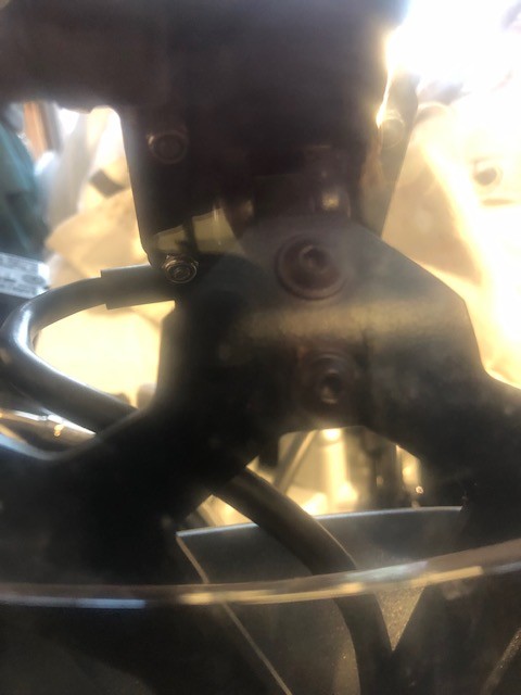

    Yes and more worrying was the way the sat nav (mines a Garmin 660) was bouncing around
    Tbh the bracket isnít fit for purpose because of the way it mounts on the bike
    To solve the screen moving down I fitted a very thin washer behind the spring on both of the top screen slide mounts.
    I nearly returned the bracket but I already had a Triumph mount as well ( mounts to handlebars) so I cut the Evotech down and fitted part of the Triumph mount to it to reduce the ďoverhang/cantileverĒ and therefore the bouncing
    Works ok now - will try and post a pic tomorrow

    Thanks.  I don't have vibration issues.  But the screen lowering is a pita.  I'd love to see the pics.

    Hopefully uploaded pics. Sorry they are not too clear as not in a position to remove the screen atm (and I have a locking device fitted to secure the Garmin in the mount that makes it more confused).  As I said I cut the Evotech short  then I cut a block of Aluminium to fit the bracket on the Triumph mount and bolted it to the Evotech.  Hope that makes sense.
