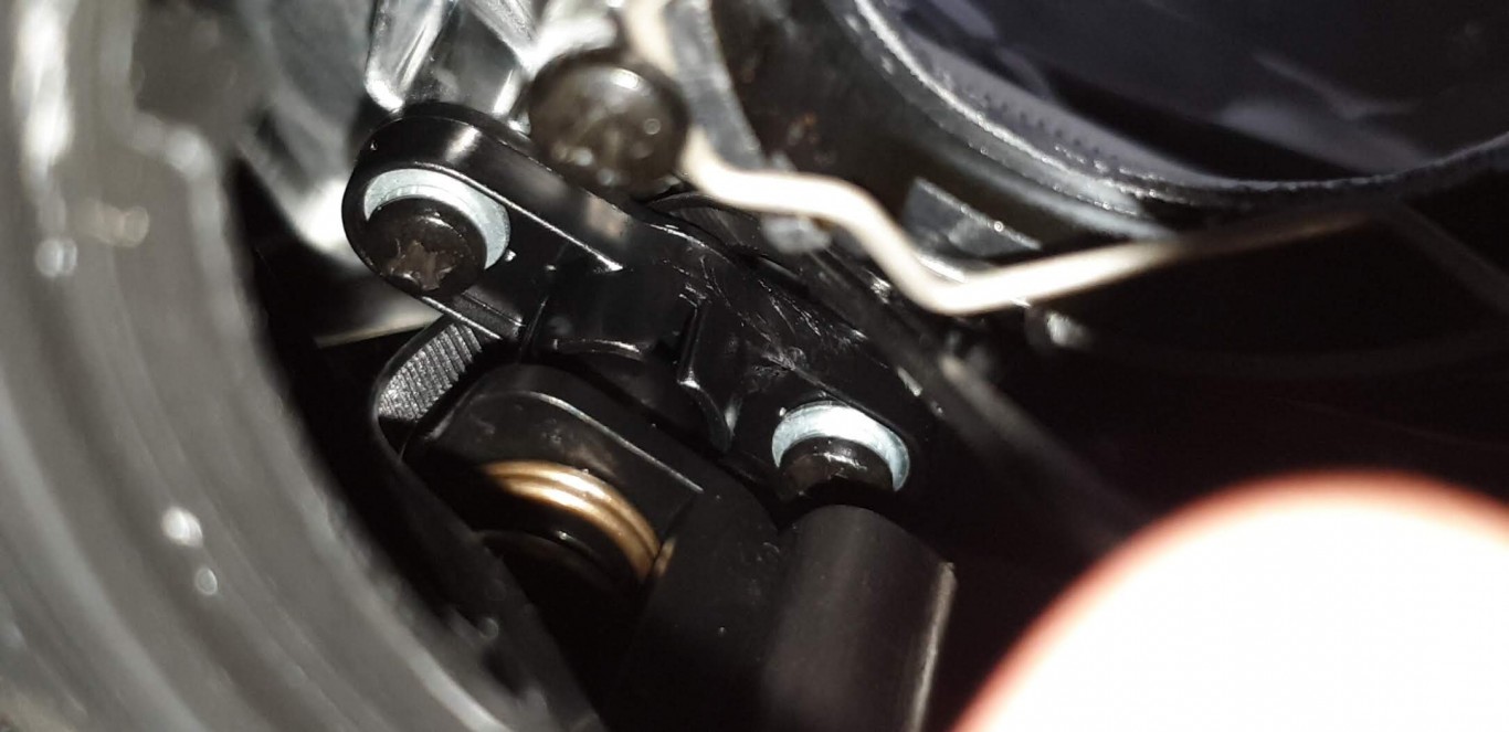

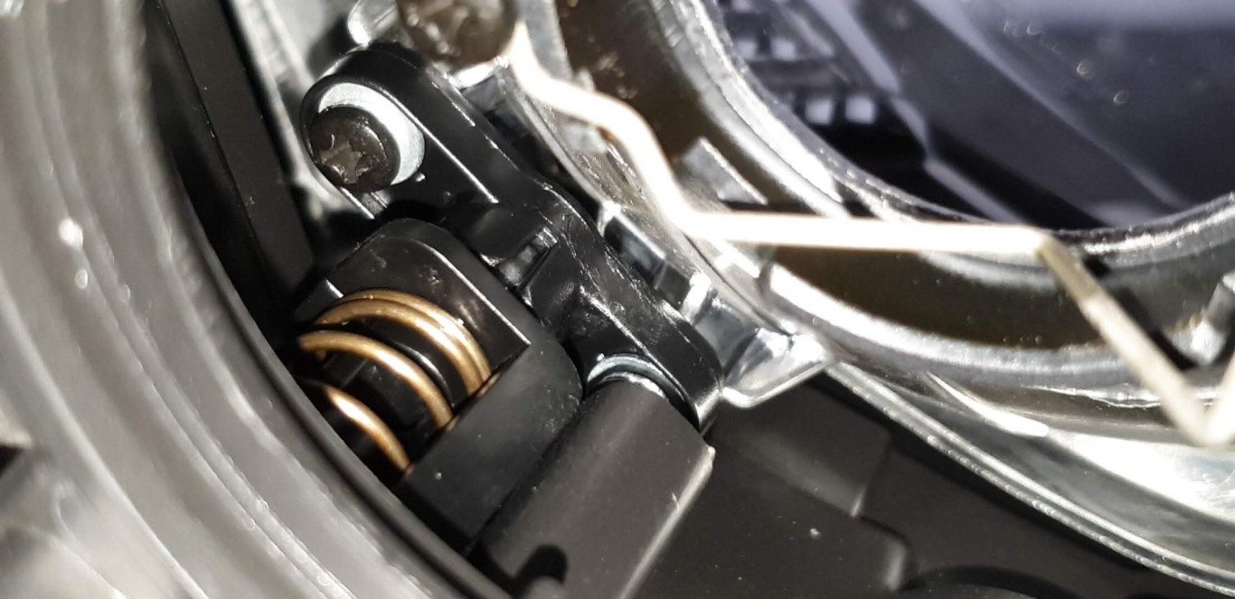

I could not adjust my headlight anymore, so I had a look at the ball joint.
And yes..  it was disconnected. Took me some time to get it in...
Some pics, last one ball joint connected again:

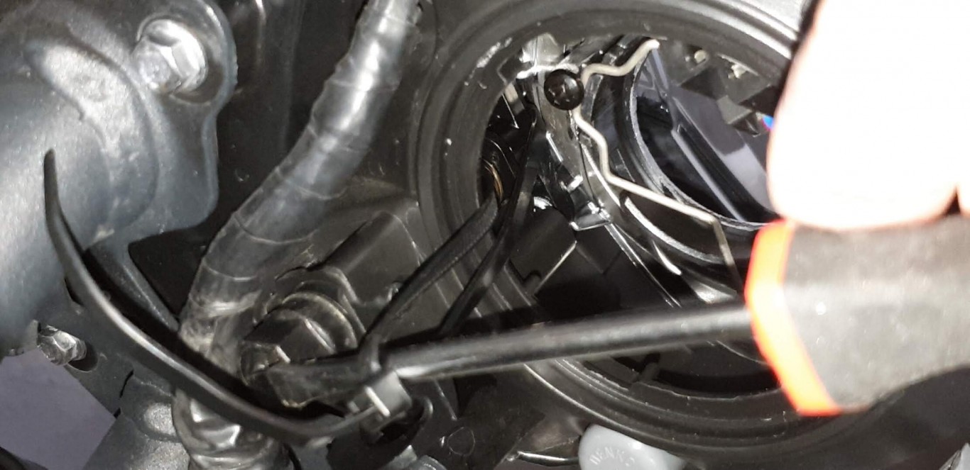

I've got the same issue.

But I found a working one. You need to use a zip tie and a screwdriver, see pictures:

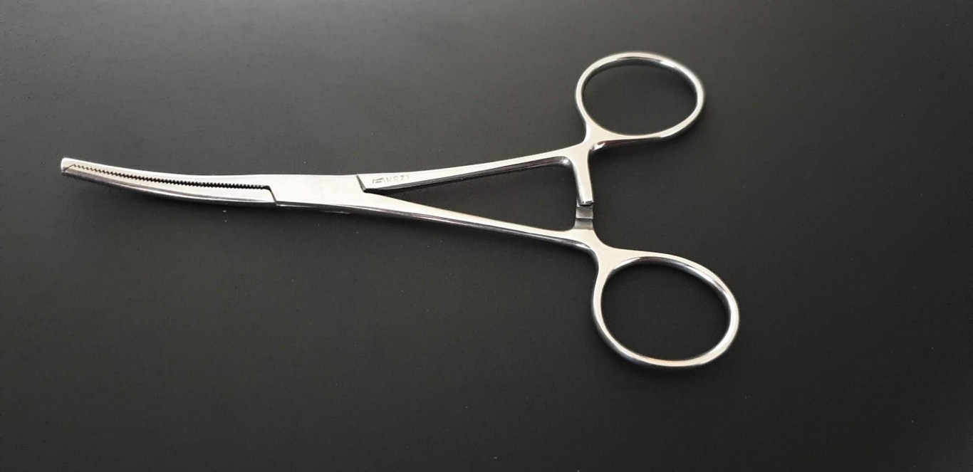

(Good to have a curved Kelly forceps also to roven the zip tie)
